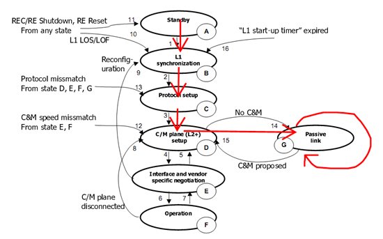

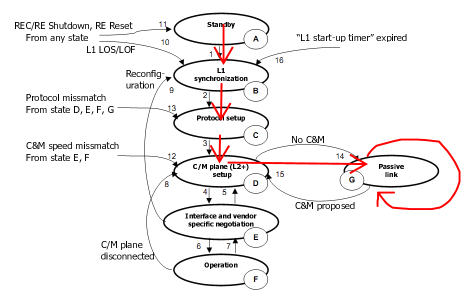

    I have been working for four days on synchronizing DSP and FPGA, but I couldnt handle the problem. I see, L1 synchronization is established  and Protocol version setup is done between DSP and FPGA but than FPGA enter the Passive Mode and the link stay in Passive Mode.

    The other problem on FPGA side is when I read CPRI CORE's Status Register I see the link always in "passive link" mode. According to the CPRI Spesification V2.1, we have failed on C&M Plane Setup. How must we setup C&M Plane to work correctly.

    About C&M plane setup, AIF HW don't care about that. it should be handled by your high level application. AIF just can transfer CPRI control word with L1 inband signals. we don't have any example or recommendation about protocol layer operation. most of our customers have their own way to handle those protocol layer operation but we don't know the detail.
