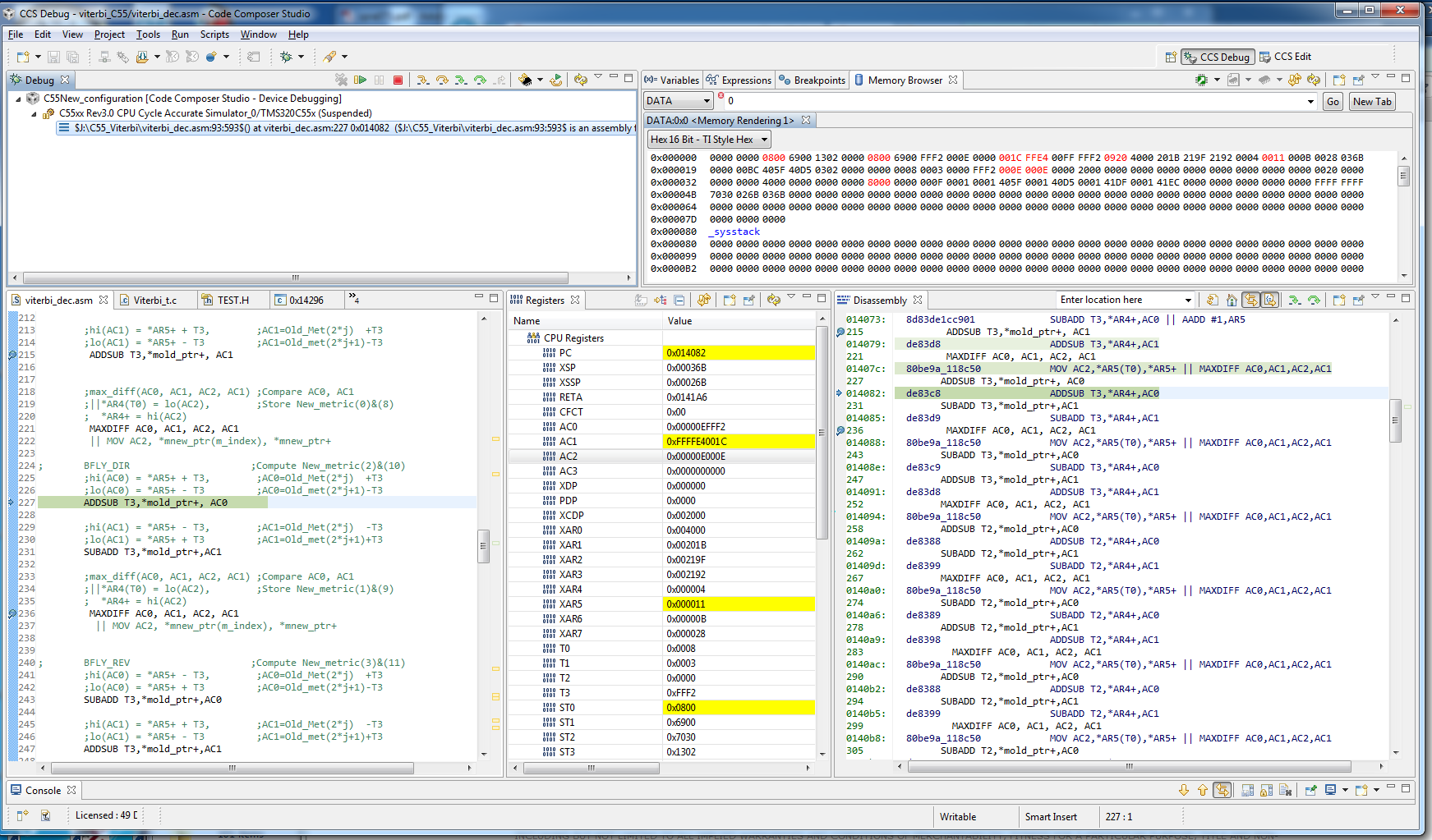

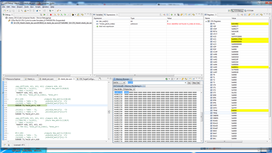

Why does the results not behave as what I expect?
I debug a C55 routine, see below please.
218           ;max_diff(AC0, AC1, AC2, AC1) ;Compare AC0, AC1
219           ;||*AR4(T0) = lo(AC2), ;Store New_metric(0)&(8)
220           ; *AR4+ = hi(AC2)
210           MAXDIFF AC0, AC1, AC2, AC1
211           || MOV AC2, *mnew_ptr(m_index), *mnew_ptr+
Before executing line 211, the register and memory contents are:
I am thinking about "MOV AC2, *AR5(T0), *AR5+".
AR5=0X0010, T0=0X0008, AC2=0X000032004E
The address AR5(T0)=0x0018, memory at 0x0018 is: 036B
After I step, the contents is:
I do not see memory 036B changed. Why am I wrong?

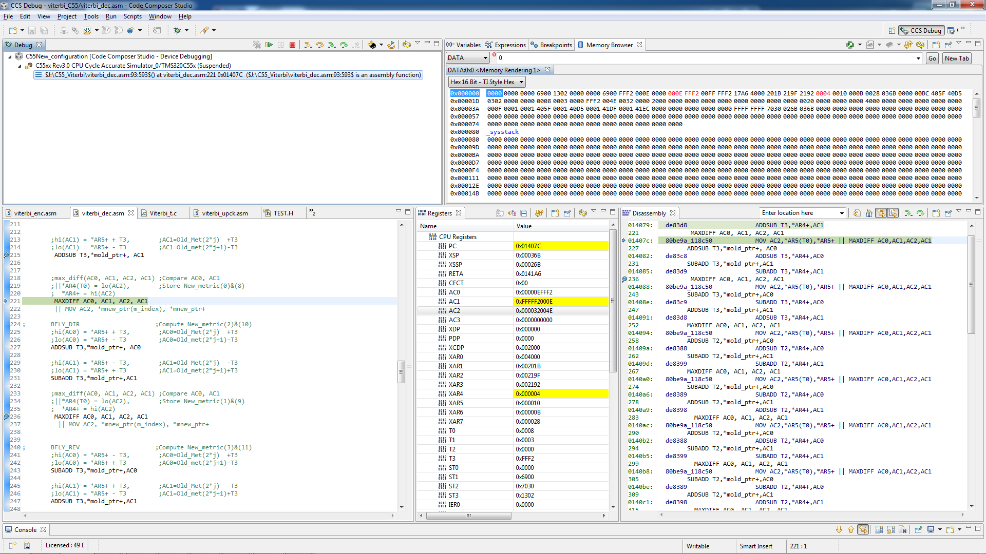

A new question about the parallism of the MOV and MAXDIFF. As the AC2 reading, I think that it should use AC2 value before MAXDIFF executing, right?
The code I cite is from an application note downloaded from TI. I attach it here.
6237.spra776a.zip

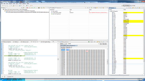

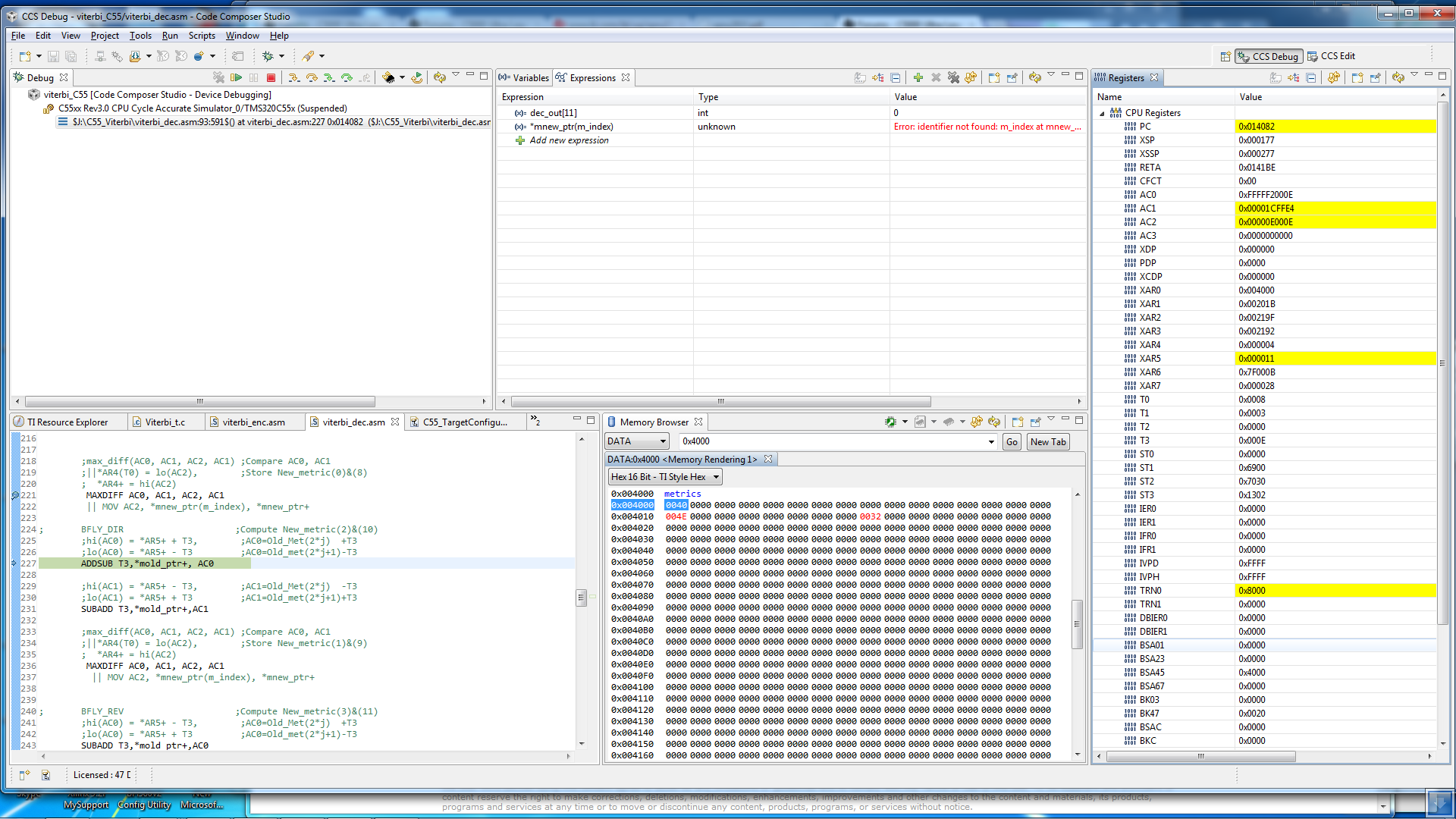

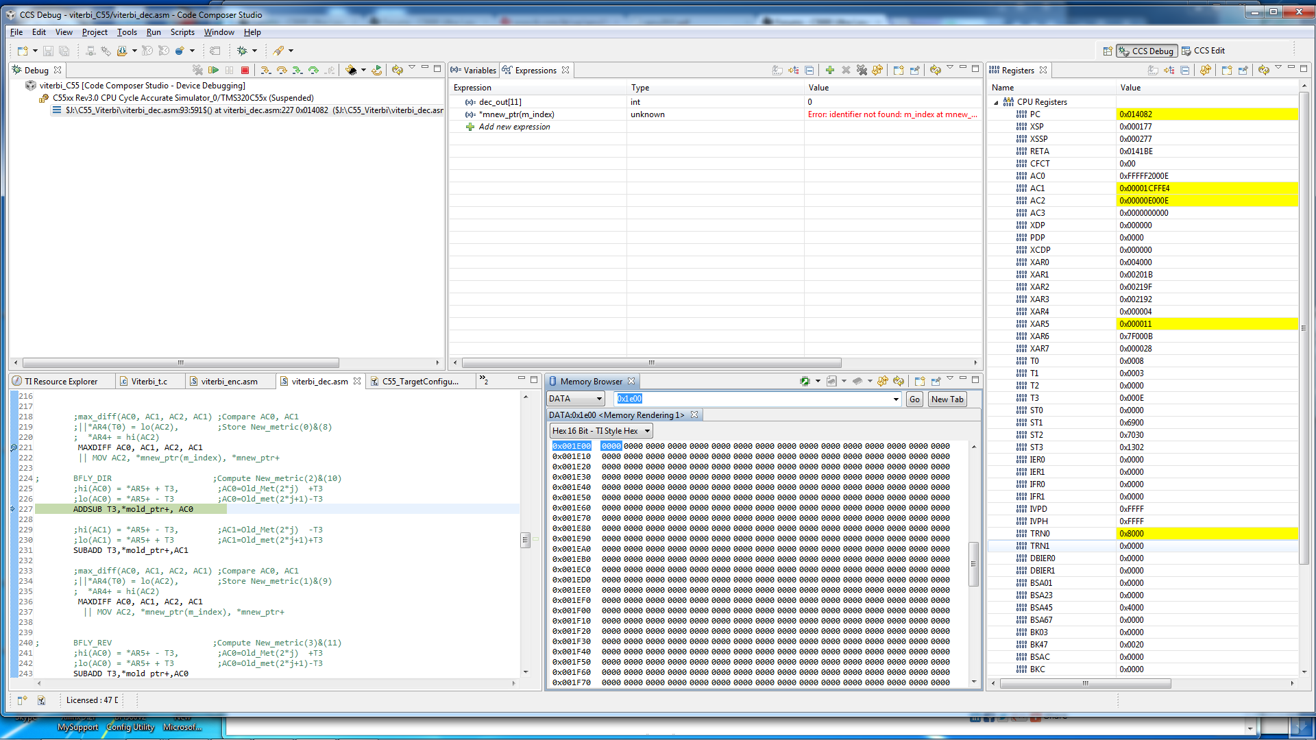

  • You are writing to a memory-mapped register.  You will get bizarre results if you attempt to read and write from that area of memory as if it were plain memory.  You should not place data there.  You need to modify your linker command file to place mnew_ptr somewhere else.
  • Actually, from looking at your executable file, you don't have any data allocated there.  This means that mnew_ptr is a stray or uninitialized pointer.  Please check that it has the correct value before executing this instruction.  This may be the result of stack overflow.  You may want to try increasing your stack size.
    I do not understand why you mention "mnew_ptr", as it does not show in the pictures. I have increased stack size to 0x5000. The console window messages are uploaded in a txt file for reference. From the Viterbi_dec.asm file, mold_ptr and mnew_ptr are circular pointers, which are alias of AR4 and AR5.

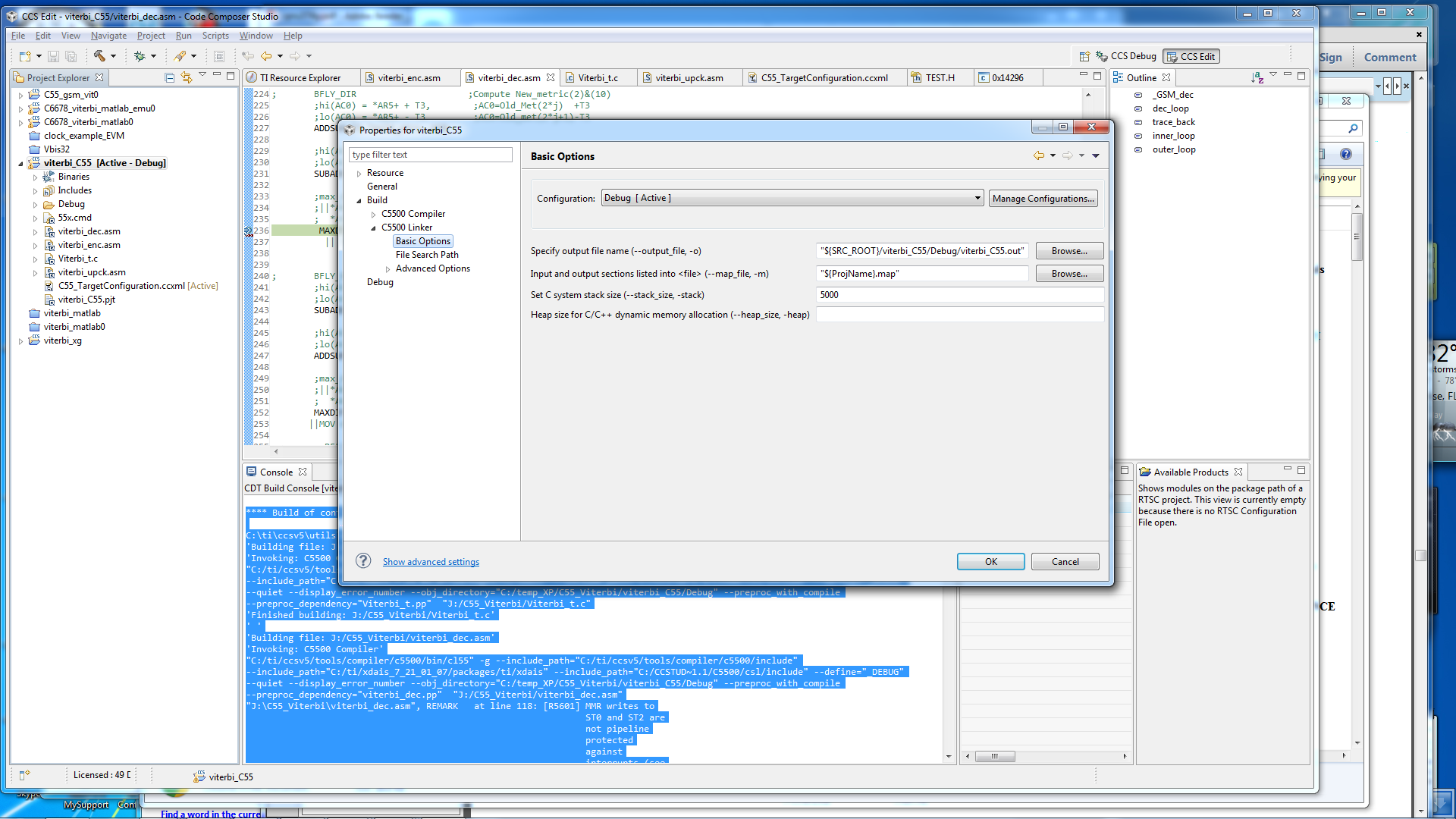

    I do not see any big difference from stack size modification before. (I have increased stack size to 0xa000, the build will be error then). Do you think the stack size is OK now? Thanks.
  • I am new to C55. Is this DSP so different from C6000? I want to understand the algorithm in C55 first. Later I would like to write the algo in other DSP core.
    Thanks.

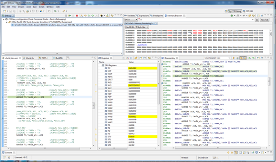

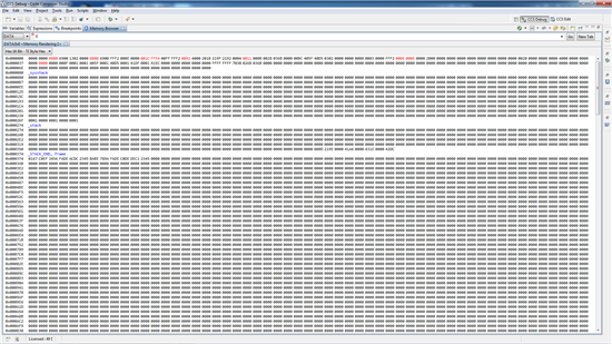

    I increase stack size to 0x5000, see the picture below:
    Why can I see the stack size is much smaller in the memory subwindow:
    They are not the same thing?
    Second question, the beginning address of stack is 0x000274? It is not the end address? Thanks.

    I see a stack definition in the 55x.cmd file. I just feel bizarre. It sets so small stack(0x200). It is a typo? I also attach 55x.cmd file in this post.
    -stack 0x200

    Although the build has no error, the result is not correct yet.
    After the same line in viterbi_dec.asm, memory 0x18 is still modified. Do you think it is wrong or not?
    Thanks again.
  • I looked at this for a while and I suspect that the problem isn't what we though it was.  You have the memory view open to address 0, expecting to see the results of the algorithm write to that location, based on the contents of XAR5 and T0, which are both relatively close to zero.  However, that is bogus.  Because XAR5 is being used in a circular fashion, the value of the BSA45 register is added to the address.  Please set the memory view to the address contained in BSA45 at the point of the MAXDIFF instruction and try again.  I believe you will see the block of 32 values at address 0x1e01 change.
  • Thank you for the analysis. I have the beginning memory contents at: 0x4000
    I am not sure 0x1e01 is the content I got:
  • Well, my guess about the exact address was wrong, but based on the value of BSA45, XAR5, and T0, that result is correct.
    So, what problem are you experiencing?
  • The result is still not I expected. However, there is no exception error or some obvious problems now. I debug the algo step by step.
    Thanks.
