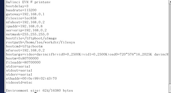

How can I boot the board(DM6446) using NFS?

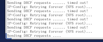

I follow the "Getting Started Guide" to set up the system,but I can't boot the board using NFS.
When I try to boot the board,
Server IP  192.168.0.2
EVM IP    192.168.0.8

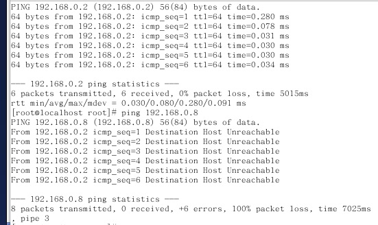

I can ping from EVM to server,but I can't ping from VM to EVM
The environment variables are as follow,
Please help me to solve this problem.Thanks!
