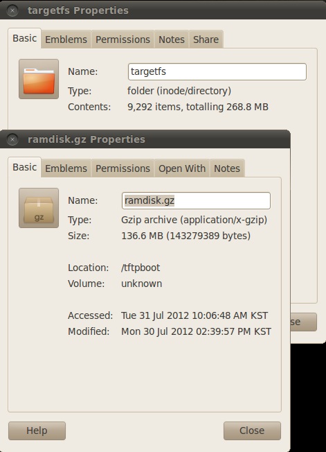

    It will be created </home/user/targetfs> folder when I install c6a816x ezsdk.,
    I tried it on nfs and jffs2.
    And I want to try to boot using ramdisk, I created ramdisk.gz file refer to the above wiki page.
    $> sudo cp -r /home/user/targetfs targetfs
    $> sudo chmod 777 -R targetfs
    $> dd if=/dev/zero of=ramdisk bs=1M count=320

    $> gzip ramdisk

    11M is the size of ramdisk.gz; change that value if your case is different. Also, verify that "partition size" parameter values of the "nand read" command are correct.

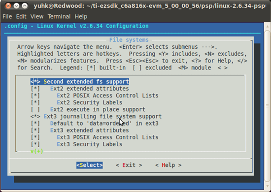

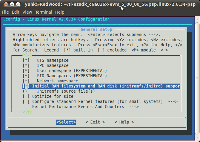

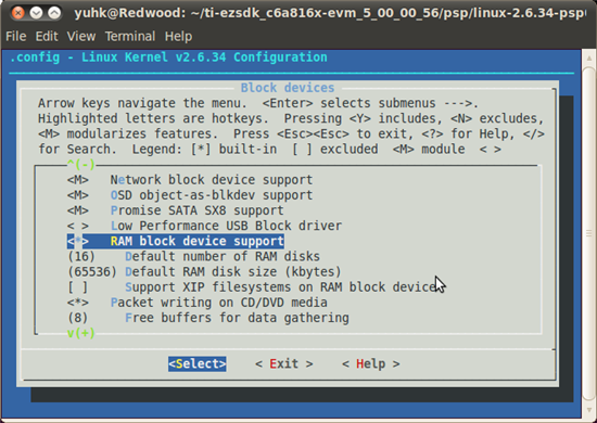

    I tried that, kernel message is :

    Linux version 2.6.34 (x0029463@swubn01) (gcc version 4.3.3 (Sourcery G++ Lite 2009q1-203) ) #1 Thu Nov 18 22:18:53 IST 2010
    CPU: ARMv7 Processor [413fc082] revision 2 (ARMv7), cr=10c53c7f
    CPU: VIPT nonaliasing data cache, VIPT nonaliasing instruction cache
    Machine: ti8168evm
    bootconsole [earlycon0] enabled
    reserved size = 0 at 0
    Memory policy: ECC disabled, Data cache writeback
    OMAP chip is TI8168
    Built 1 zonelists in Zone order, mobility grouping on. Total pages: 65024
    Kernel command line: console=ttyS2,115200n8 mem=256M earlyprintk root=/dev/ram rw initrd=0x82000000,11M

    The problem is creating ramdisk.gz.
    Here you can see block size of NAND :
    http://processors.wiki.ti.com/index.php/DM816x_AM389x_PSP_U-Boot#U-Boot_NAND_Support
    Micron Nand parts (page size 2KB, block size 128KB) are supported on DM816xEVM platforms.
    So,
    In this wiki page,  http://processors.wiki.ti.com/index.php/Creating_a_RAMDISK,
    [root@localhost jjd]# dd if=/dev/zero of=ramdisk bs=1M count=32 32+0 records in 32+0 records out 33554432 bytes (34 MB) copied, 0.243921 s, 138 MB/s
    is right?
    I tried the following :
    $> dd if=/dev/zero of=ramdisk bs=128K count=2660
    2660+0 records in
    2660+0 records out
    348651520 bytes (349 MB) copied, 2.48309 s, 140 MB/s
    But failed.

    $> gedit .config
    $> make –C ./ ARCH=arm CROSS_COMPILE=/home/user/CodeSourcery/Sourcery_G++_Lite/bin/arm-non-linux-gnuebi- uImage

    $> cd ti-ezsdk_c6a816x-evm_5_00_00_56/psp/linux-2.6.34-psp04.00.00.07
    $> gedit .config
    CONFIG_INITRAMFS_SOURCE="/home/user/target_fs"
    CONFIG_BLK_DEV_RAM=y
    CONFIG_BLK_DEV_RAM_COUNT=320
    CONFIG_BLK_DEV_RAM_SIZE=335544320
    CONFIG_BLK_dEV_RAM_BLOCKSIZE=1048576

    Please, also be sure to check this:
    "Then, if you compile the kernel, e.g. by make uImage, the cpio archive is generated and embedded into the kernel:
     CHK     include/linux/compile.h
     GEN     usr/initramfs_data.cpio.gz
     AS      usr/initramfs_data.o
     LD      usr/built-in.o
    Thank you.
    BR
  • About initramfs :
    http://processors.wiki.ti.com/index.php/Initrd - initramfs - installation,
    "If you start the kernel, the initramfs is already there. Therefore, there is no root=/dev/ram0 rw initrd=0x87000000,8M bootargs option necessary. Remove this if you still have it!"
    So I deleted the bootargs.
    And set 'bootargs=console=ttyS2,115200n8 mem=512M earlyprintk' also.
    In addition, kernel size is 116MB. Is it right?
     LD      usr/built-in.o
    I have checked that.
    Could you explain about 'initramfs - creation'?
    Especially init.
    I'll try to above initrd.
    I'm so sorry but please help.

    target_fs size is 72.9MB4130.target_fs.tar.gz
  • I succeeded in the initrd.
    kernel compile
    $> cd c6a816x/psp/linux
    $> make -C ./ ARCH=arm CROSS_COMPILE=/home/yuhk/CodeSourcery/Sourcery_G++_Lite/bin/arm-none-linux-gnueabi- ti8168_evm_defconfig
    .config;
    CONFIG_BLK_DEV_RAM_SIZE=3277680
    $> make -C ./ ARCH=arm CROSS_COMPILE=/home/yuhk/CodeSourcery/Sourcery_G++_Lite/bin/arm-none-linux-gnueabi- uImage
    $> make -C ./ ARCH=arm CROSS_COMPILE=/home/yuhk/CodeSourcery/Sourcery_G++_Lite/bin/arm-none-linux-gnueabi- modules
    $> make -C ./ ARCH=arm CROSS_COMPILE=/home/yuhk/CodeSourcery/Sourcery_G++_Lite/bin/arm-none-linux-gnueabi- linux_install
