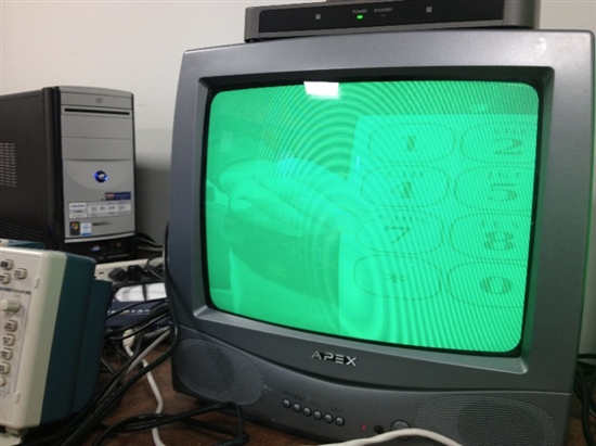

Hi ,
I am doing a composite video capture (480i ) using TVP5147 video decoder on DM8148 EVM  . I am using EZSDK 5.04 .
We have added a  TVP5147 driver in the hdvpss source . We are able to do 480i video capture successfully using chains application  .  The chains application captures 480i video on VIP Capture Port 2 and displays on SD display .
here is the Capture driver Statistics is chains application .

This is the snapshot taken when the chains application is running ,its all fine with the display except the colors are not proper .
Now when I do a 480i  capture using OMX application ,I see only half of the display clearly and the other half is noise . The OMX application has got only capture and display components . capture_display omx app does the 480i capture on VIP port 2 and displays on SD display . The OMX CTRL component is able to configure TVP5147 video decoder correctly as i can see from the logs .
Capture driver advanced Statistics for OMX capture_display application .

As we can see from the above data ,the odd fields are continuously dropped and only even fields are captured .
This is the snapshot taken when doing a 480i video capture using OMX application  .  As we can see only top half of the display is clear and the bottom half is noise . What could be the reason for odd fields getting dropped when doing capture with OMX application .
I have set pVFCCComPvt->bFieldMerged = OMX_TRUE;
storagePrms.bufferFmt = FVID2_BUF_FMT_FIELD ; (for a field based capture )  ,when i set storagePrms.bufferFmt = FVID2_BUF_FMT_FRAME , I am able to capture only two frames and the application hangs .
Can anyone help us out in understanding the above problem ? what would be the problem in the OMX framework ? any  help is appreciated  .

    I'm also trying to get the TVP5147 (on the DM8168 EVM btw) up and running but am having some issues getting the correct data out of the 5147 (or perhaps into the 8168). As you'll see in the attached image, when configured with (VPS_CAPT_VIDEO_CAPTURE_MODE_SINGLE_CH_NON_MUX_EMBEDDED_SYNC + VPS_CAPT_VIDEO_IF_MODE_16BIT) the data is all green and seems to be 'double-width'.
    Looking at the logs in this post (thank you) it seems that the DM81XX_VIP connnected to the TVP5147 as  "VIP1 PortA capture mode is [16-bit, Non-mux Discrete Sync (HSYNC/VSYNC)" (which I believe to be VPS_CAPT_VIDEO_CAPTURE_MODE_SINGLE_CH_NON_MUX_DISCRETE_SYNC_HSYNC_VSYNC + VPS_CAPT_VIDEO_IF_MODE_16BIT).
    If this is the case, perhaps you could share how you have configured the TVP5147 registers (eg 0x33 == output mode, others?)
    If it's of any help, below is how I currently have things configured:

    pVipCreateArgs->numCh = 1;
    /* produces 'double-width', green image */
    pVipCreateArgs->videoCaptureMode = VPS_CAPT_VIDEO_CAPTURE_MODE_SINGLE_CH_NON_MUX_EMBEDDED_SYNC;
    pVipCreateArgs->videoIfMode = VPS_CAPT_VIDEO_IF_MODE_16BIT;
