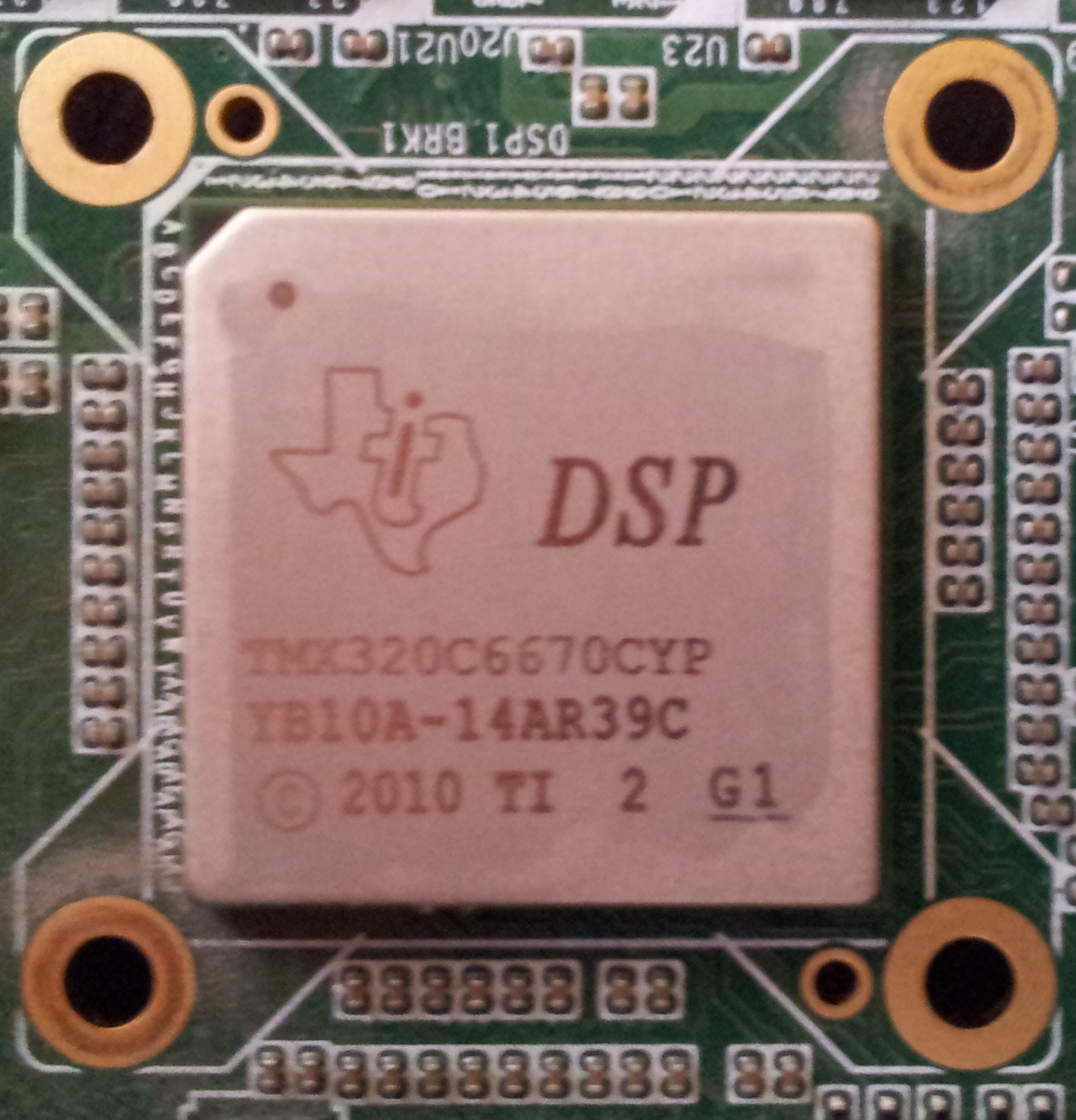

Hello, everyone.
This is a kind of simple question, but I would like to know what is the meaning of all the numbers printed on the DSP package. The first one is clearly the part number, but what is the meaning of all its parts? Does the second line mean any part specification or is just a serial number?
Please take into account I need to know if this device support security features as encryption of the loaded program.
Adrian
  • Adrian,
    The datasheet explains the part number nomenclature and the errata document explains the device markings for device revisions.
    Any features that are not specified in those two documents will depend on whether they are standard features as described by the datasheet or are enabled within your purchase contract with TI or your Authorized TI Distributor.
    After looking at these documents, if you still have questions, please reply back. Or mark this thread Answered if you now have your answer.
    RandyP
  • Randy, I checked the documents you suggested and I clarified my doubts about the part numbers.
    Thank you for your help and good luck.
