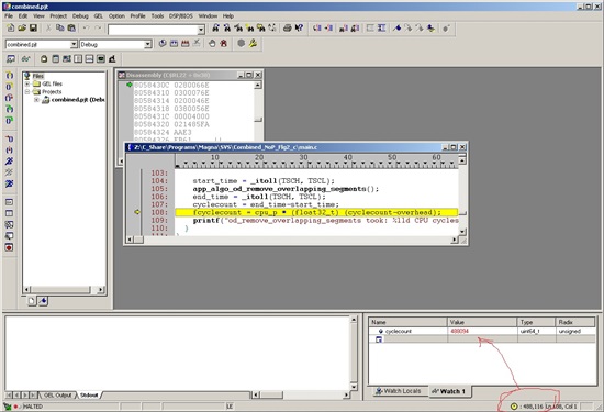

  • Plese see attached CCS screen shots for your project setup.
  • Once you succeed in building your project with these addition, you should be able to profile any function accordingly.

  • Grtns,
    Likely then the C6727 support you are using is not up to date.
    Here is your primitive method.
    Load your run time and go to main.
    From the drop down under profile, enable and view clock.
    Run to where your function is at.
    double click your mouse on the clock counter to clear it.
    Step over your function,
    Your clock counter will give you an accurate count of the clock cycles used.
    Please see attached
