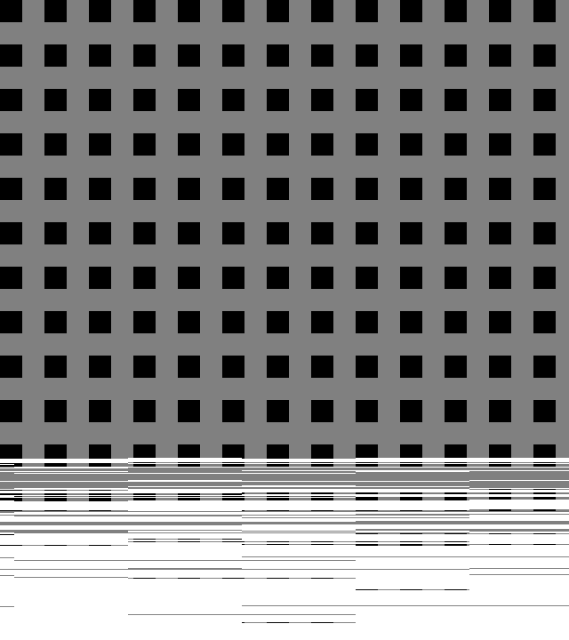

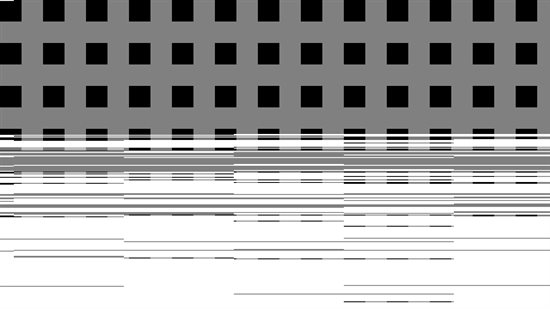

I am trying to implement a fairly basic VICP routine which downsamples an 8-bit greyscale image by 2 using the imxenc_average2x2 command on a DM648.  For some reason, approximately the bottom 205 pixels are only partially written out as well as the first 16 pixels on the first row.  (See the two bitmap attachments for the output on two different images one 1280x720, the other 1280x1440.)  I have tried changing several parameters, including processing block size, and this seems to have no effect on the output, including the nature of the artifacts.
I am not sure what could be going wrong here.  Could it be a DMA bug?  I have never seen anything use imxenc_average2x2.  Am I using it wrong?  I have also attached the  relevant VICP functions in downSamp2VICP.c.
Thanks in advance
