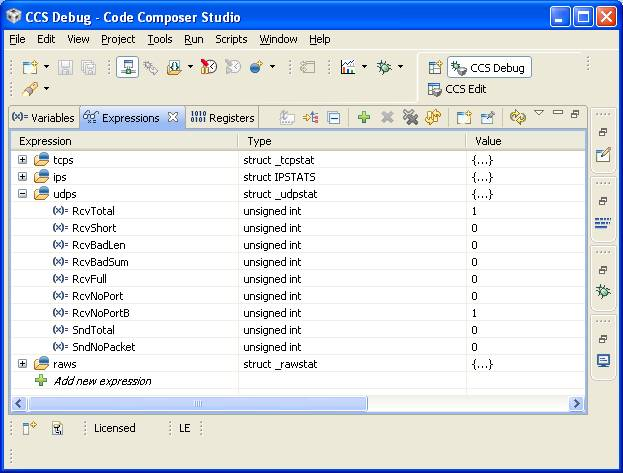

I have a simple ndk udp application. I'm using a C6678 evm. i am trying to communicate with the ndk application from a pc connected to the board. The pc side implementation uses windows socket implementation.
i find that i am able to send and receive messages on both ends when my messages are of 10 bytes or below 10bytes. When my messages are above 10bytes i find that recvfrom remains blocked, it does not seem to come out of the blocked state. I'm sure i am missing out something silly. Does anybody have any suggestions on what i might be doing wrong?
