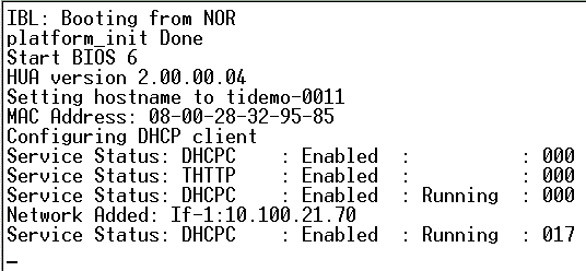

I setup the said EVM.  I connected RJ-45 to my network hub and booted up OK.  See the COM port output below.
But as soon as the EVM is up, all my devices connected to the hub lost network connection.  When I disconnect EVM's network cable.  The network connections restored.  What might be the problem?  Thank you.

    Here is the power on test result, all pass.
    TMDXEVM6657L POST Version 01.00.00.01 ------------------------------------------ SOC Information
    FPGA Version: 000F Board Serial Number: 0011 EFUSE MAC ID is: 08 00 28 32 95 85 PLL Reset Type Status Register: 0x00000001 Platform init return code: 0x00000000 Additional Information:    (0x02350014) :0BEF0000    (0x02350624) :000211FF    (0x02350678) :00123400    (0x0235063C) :000801FF    (0x02350640) :000801FF    (0x02350644) :000900DB    (0x02350648) :000A40DB    (0x0235064C) :000B10DB    (0x02350650) :000C00DB    (0x02350654) :000C00DB    (0x02350658) :000C00DB    (0x0235065C) :000D1800    (0x02350660) :000E1800    (0x02350668) :000F1800    (0x02350670) :00101800    (0x02620008) :0201A005    (0x0262000c) :040101A7    (0x02620010) :00000000    (0x02620014) :054A0000    (0x02620018) :0B97A02F    (0x02620180) :0602F000 ------------------------------------------
    Power On Self Test
    POST running in progress ... POST I2C EEPROM read test started! POST I2C EEPROM read test passed! POST SPI NOR read test started! POST SPI NOR read test passed! POST EMIF16 NAND read test started! POST EMIF16 NAND read test passed! POST EMAC loopback  test started! POST EMAC loopback  test passed! POST external memory test started! POST external memory test passed! POST done successfully!
    POST result: PASS
    Then I put SW5 bit 4 back to off, pressed cold reset bottom, the network works fine now.   Why?  What have we corrected by running POST?
