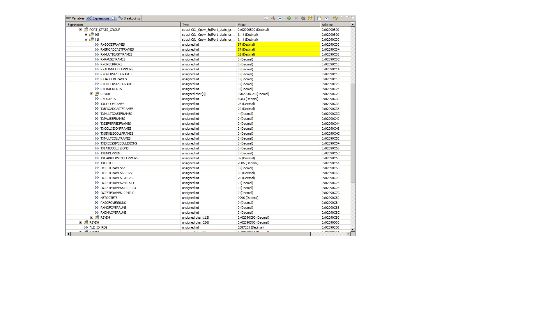

    We are geting there. Can you show me the rx and tx statistics of CPPI port (0x2090b00)? Please dump the following memory location in 32-bit format:
             0x2000000-0x200005f (24 32-bit words) after you forward the packet.
    Is it possible to use a private (controlled) network, so that we know what and how many packets are delivered to the EVM board.
    Eric
  • Hi Eric,
                Thanks for your reply.
           w.r.t to you question [Is it possible to use a private (controlled) network, so that we know what and how many packets are delivered to the EVM board.]
    Yes, my network is private controlled, i mean i have pc/laptop connected to EVM [c6670] board through a straight cable [its a point to point connection].
    from udp packet generator, i sent 2 packets and here i am attaching the captures

    i have a doubt, the address 0x2090b00 belongs to [EMAC port 0 = SGMII_0 = switch port 1 = AMC backplane lines]
    i have a doubt, the address 0x2090c00 belongs to [EMAC port 1 = SGMII_1 = switch port 2 = RJ45 connector] ? please confirm/correct my understanding.

  • Hi Eric,
               based on your suggestion, i made the changes as below
    //if(cpswLpbkMode != CPSW_LOOPBACK_NONE)
    CSL_CPSW_3GF_enableAleBypass();
    Now with above changes, i pumped in 10 packets [in which only 5 packets are correct and remaining 5 packets are incorrect, this is due to bug in packet generator tool :-( ], so based on that 5 packets will be custom packets which will reach the Rxqueue [host queue]  after all classification checks.

    with the code changes above, the example works for 5 packets [which is inline with my expectations]. Thanks Eric and now i have to investigate why and how this ALEBypass condition affected my project.
    RC Reddy
  • Hi, RC:
    It is better to disable CPSW functionality at your use case since you just want to connect EMAC port 1 (CPSW port 2) to CPPI port  (CPSW port 0).
    - Disable ALE learning (optionally). Switch_update_addr(): alePortControlCfg.noLearnModeEnable = 1;
    - Enable ALE Bypass: Init_Switch(): CSL_CPSW_3GF_enableAleBypass();
    - Specify the output port number at all egress packets. emacExample/cppi_qmss_mgmt.c/SendPacket()

  • Hi Eric,
              Thanks for your reply. I was able to send packets from PC udp gen to evm c6670 without BYPASSING ALE and in return from evm to pc.
    RC Reddy
