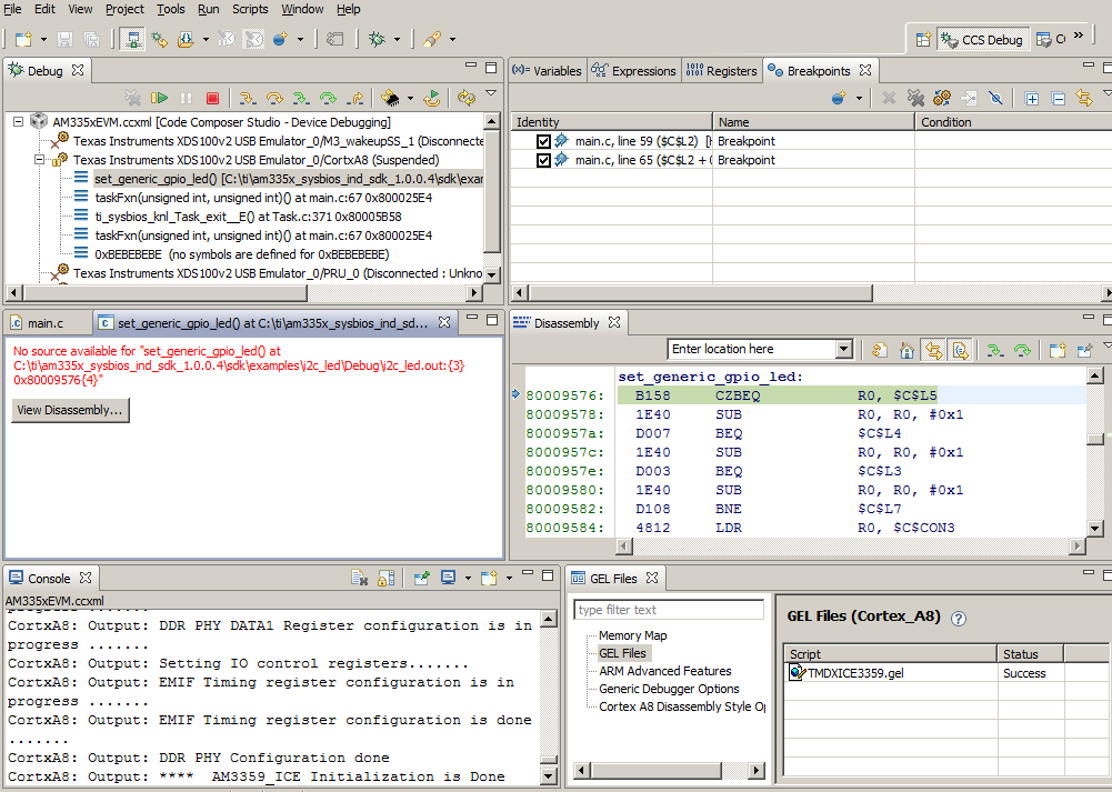

With the AM335x ICE board I am able to load the i2c_led example that is included in the SYSBIOS Industrial SDK (C:\ti\am335x_sysbios_ind_sdk_1.0.0.4\sdk\examples\i2c_led)  and run it but I am unable to step through certain functions. For example, I put a breakpoint inside of the taskFxn function and when I start stepping through the code I am unable to step into the set_led function. Is there a way to step through the C code that is being executed inside this function?

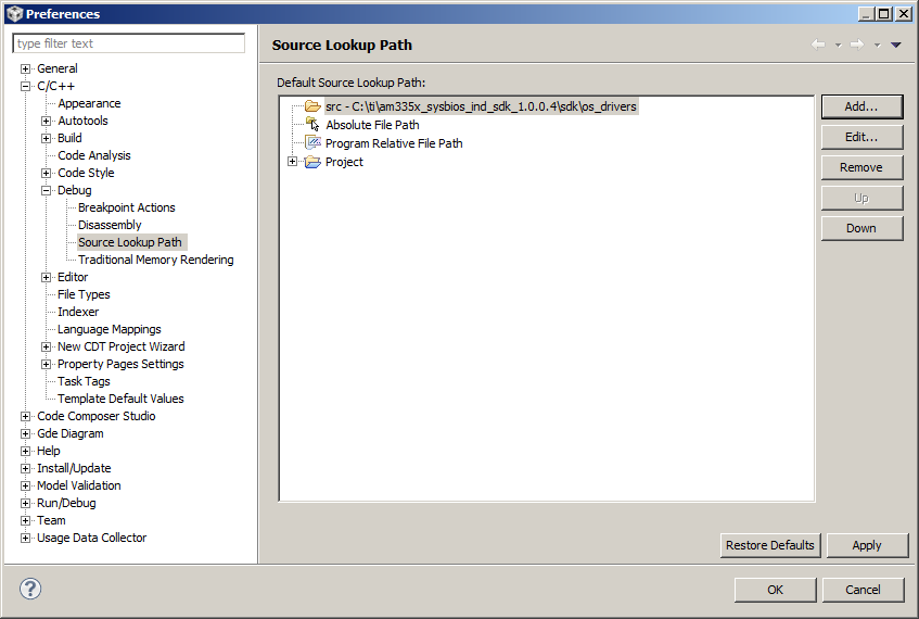

  • It's because the code is part of a .lib that is just being linked into your project, so CCS doesn't know where to find the original source code when you want to debug.  You can provide additional source code paths for debugging under Window..Preferences..C/C++..Debug..Source Lookup Path.  In your case, you would need to set a reference to C:\ti\am335x_sysbios_ind_sdk_1.0.0.4\sdk\os_drivers\src, where the source sys_led.c file is located (which contains set_led()).

  • Unfortunately that did not work. I did the following steps:
    Menu->Window->Preferences->C/C++->Debug->Source Lookup Path->Add->File System Directory->C:\ti\am335x_sysbios_ind_sdk_1.0.0.4\sdk\os_drivers\src
    But when I try to step into set_led() it still doesn't work. If I do an Assembly Step Into I get the following message "No source available for "set_led() at C:\...\CCS Workspaces\ICE\i2c_led\Debug\i2c_led.out:{3} 0x80009566{4}" .
  • Yes, I seem to recall when I've used this feature in the past that it's a little bit dodgy.  I think I had to play around with the "type of source to add" (absolute file path vs. file system directory etc.), and even then I think I had to restart CCS after chaning things to get it to work right.  I didn't use it extensively but I did get it to work, so if you play around with it a little bit hopefully you should be able to get it working too.
