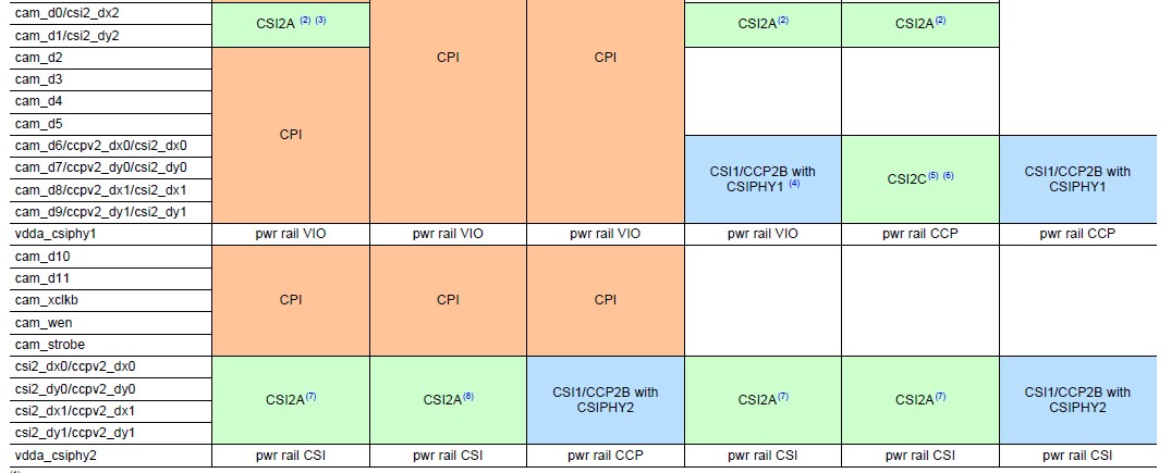

In the DM37X TRM, Table 6-3. Camera ISP Connectivity Schemes, there are 6 schemes. Scheme 5 shows that CSI2A and CSI2C are on. But csi2_dx0,csi2_dy0,csi2_dx1 and csi2_dy1 are muxed with cam_d6~d9, and i cannot find other csi2_dx0/ccpv2_dx0~csi2_dy1/ccpv2_dy1pin on pin define. How do i connect 2 mipi cameras to DM37x? Are csi2_dx0/ccpv2_dx0~csi2_dy1/ccpv2_dy1 pins same to cam_d6~d9?
