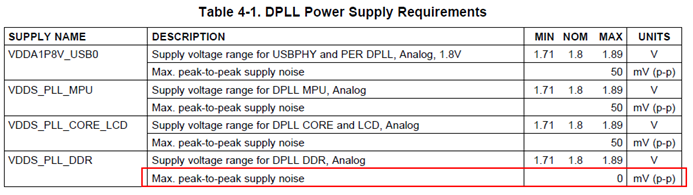

 Hello, I am currently considering using the ARM processor, AM3358 and have a few questions about it as stated below
1.    About the DPLL Power Supply Requirement
 The table above indicates that “Max peak-to-peak supply noise” of “VDDS_PLL_DDR” is 0 mV.
 I would like to make sure that this information is correct. Could you confirm whether or not “Max peak-to-peak supply noise” of “VDDS_PLL_DDR” is 0 mV ?

  • Thanks for highlighting the AM335x Data Sheet error.  The Max peak-to-peak supply noise of VDDS_PLL_DDR should be 50 mV.
