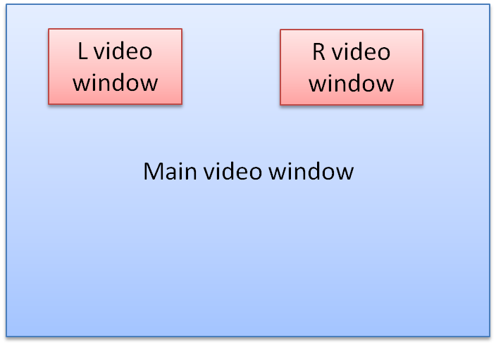

    Let me give you my use case detail. I want to create a simple application to achieve following.
    Do you think I can achieve this by blending or transparency keying or any other method ?

  • Hi Sweta,
    I now can understand what you are trying to do. There is no way to have 3 video pipeline connected to compositor, we could have at max 2 video and 3 grpx.
    I think what Hardik suggested would be a better option, you could use any Mem2Mem driver to composite 3 videos and create one frame, which you could display using video display path.

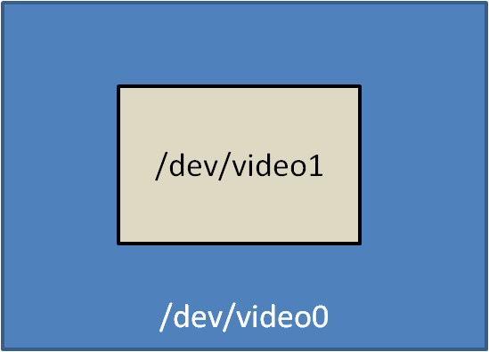

    In addition, one thing I wanted to confirm is that, two video windows can be overlaid on each other (without color keying or any other operation), showing the content of both the video windows as shown below.
    While I tried this, I can see only one video window which has higher priority. Is it a limitation ?
    Sweta
  • Hi Sweta,
    We dont suppor small video window over big video window, even compositor requires all input windows to be of same size.
