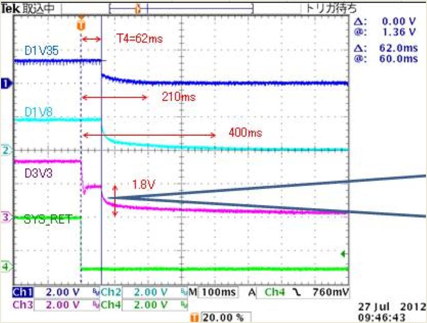

DM365 power-off sequence
Dear all,
I measure the power off sequence waveform as below,  the 1.8V will reverse voltage to 3.3V when I turn off power. Can anyone give some hints on this portion and guide me to resolve this problem? Thanks a lot.
B.R.
OC
