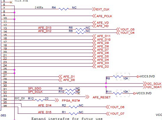

Now we are designing a 4-CH SDI DVS ,We use APPRO IPC8127 platform for it.We plan to use following configuration for our DVS.
1,We use a DSP for 4-CH SDI input .The DSP features as follows:
Buit-in HD-SDI receiver,
support 1920*1080P 30/25Hz
Video output: 16bit BT.1120
We want to know the video output (16bit BT.1120) should be connected to which pin of DM8148. APPRO IPC8127 EVM is connected to 9J003 sensor board.but the video output of 9J003 is not 16bit BT.1120.the circuit diagram below:
2、We want to confirm if we can use the pins of DM8148  connected to 9J003 sensor board to be connected to the video output of the DSP.if can,how to configurate?
3、if can't. which pins of DM8148 to be connected to the video outout(16bit BT.1120) of the DSP? I think the video input(16bit BT.1120) of DM8148 as follows:
VIN[0]A_(D7-D0)      Cb/Cr(AA11、AH16、AG16、AH8、AE12、AC9、AB11、AF9)
VIN[0]A_(D15—D8)  Y(AC14、AC12、AF17、AG17、AH17、AH9、AG9、AB15)
 VIN[0]A_CLK     (AB20)
Please let me konw if this pins of DM8148 is suitable for the DSP.If I am right ,how to configurate DM8148?
