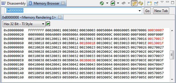

I am trying to bring up a custom board with AM3359 and MT46H64M16LF-6 LPDDR. I am having some issues with data read back.
My simple test writes a value to every address (0x00, 0x01, 0x02, etc), and then attempts to read back the value. The lower word for most addresses reads back correctly. The upper word for every memory location reads back as 0x0000.
Every fourth address always reads as a "0x00000000".
If I read the same memory address repeatedly, it does not always return the same value.

  • Update:
    The Upper word always reads back the same value. For my original test, I was writting 0x0000, but I switched it to 0xDEAD and it reads back 0xDEAD in every upper word as well as every 4th address will read back as "0xDEADDEAD".
  • I have verified that the DDR CK signals are running at 166 MHz.
  • I modified the timing registers and am having some success.
    Here is my test:
    for ( k = 0; k < RAM_LENGTH; k++ )
    pRam[k] = k + ((k+1) << 16);
    if ( pRam[k] != (k + ((k+1) << 16)) )
    err[i]++;
    Failures are about 25% of the time, or every 4th 32-bit address.
    If I use a Memory Browser in CCS set to address 0x8000_0000, with continuous refresh enabled, Some values are changed. These are predominately in at every fourth 32-bit address (offsets of 0x0C, 0x1C, 0x2C, 0x3c...).
    Additionally, the value at address 0x8000_0000 is being returned as 0xFFFF_FFFF.
  • It looks like you still have a timing issue.  Double check both the DDR PHY Register settings (use the Ratio Seed Spreadsheet to obtain the proper values for your board) and the AC timing register settings (use the AM335x DDR Calculation too for the proper values for your board)
    If you think you have all of those correct and are still seeing errors, try adjusting CMDx_PHY_CTRL_SLAVE_RATIO higher:  0x100 or 0x200.
    James
  • Increasing CMDx_PHY_CTRL_SLAVE_RATIO make the issue worse.

  • Jay, you shouldn't need to touch any other PHY registers other than the ones explained in the wiki.  Here is an example from an EVM with LPDDR:
    #define  CMD_PHY_CTRL_SLAVE_RATIO        0x80
    #define  CMD_PHY_INVERT_CLKOUT           0x0
    #define  DATA_PHY_RD_DQS_SLAVE_RATIO     0x40
    #define  DATA_PHY_FIFO_WE_SLAVE_RATIO    0x52  //RD_DQS_GATE
    #define  DATA_PHY_WR_DQS_SLAVE_RATIO     0x0
    #define  DATA_PHY_WR_DATA_SLAVE_RATIO    0x40  //WRITE_DATA
    #define  DDR_IOCTRL_VALUE                (0x18B)
    Your values may be different, but these are the only ones that need to be modified.
    Then, you also need to adjust the AC timing registers in the EMIF controller. based on the memory datasheet values.
    James
  • I got my application running from LPDDR. These are the settings I have for PHY, the do NOT match the values that were generated by the Ratio Spreadsheet.
    #define BSP_EMIF_RD_DQS_SEED (0x12)
    #define BSP_EMIF_WR_DQS_SEED (0x00)
    #define BSP_EMIF_PHY_WRLVL_SEED (0x00)
    #define BSP_EMIF_PHY_GATELVL_SEED (0x00)
    #define BSP_EMIF_PHY_FIFO_WE_SEED (0x4F)
    #define BSP_EMIF_PHY_WR_DATA_SEED (0x40)
    #define BSP_EMIF_PHY_LOCK_DIFF (0x00)
    #define BSP_EMIF_PHY_RANK0_DELAY (0x01)
    The real secret however was setting drive strength to Full. The wiki page says LPDDR should be set to 1/2, with this exception: "Some boards with LPDDR may require full drive strength depending on board size and trace impedances". It would be nice if TI could provide more guidance on that note.
