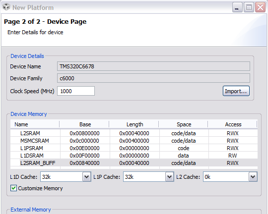

    the question in other means : how to put the buffer to be sent in a specific range in the L2SRAM knowing that my Platform information is as follows:

  • Abdalrahman,
    In the RTSC platform, you can modify it so that you split L2SRAM based on your address range requirements for your buffer. For example, let's say you want to place the buffer at starting address 0x08400000 in L2SRAM. This would be done by changing the default length of section "L2SRAM" from 0x00080000 to 0x00040000, and adding a new section called say "L2SRAM_BUFF" with base address 0x00840000, and length 0x00040000, as shown in the snapshot below:
    Now add the following in your .cfg file:
    Program.sectMap[".inputbuff"]  = "L2SRAM_BUFF";
    In your C file you can place the buffer in this region as follows:
    #pragma DATA_SECTION(buffer, ".inputbuff");
    #pragma DATA_ALIGN(buffer, 128);
    char *pBuffer = buffer[bufsize];
    Note that the 128 is not the size, it is the alignment on a 128-byte boundary. The buffer size is determined by bufsize, which should be less than or equal to the total size allocated for L2SRAM_BUFF.
    You can verify that the buffer is placed in the correct memory section of L2 by going to View-->Memory Browser.
