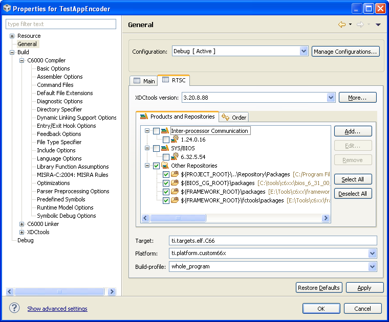

    According to the log, the "xdc.tools.configuro" command is not correctly executed due to the extra "ti.platform.custom66x" as highlighted below.
    "... xdc.tools.configuro -o configPkg -t ti.targets.elf.C66 -p ti.platform.custom66x -r whole_program -c "C:/Program Files/Texas Instruments/ccsv5/tools/compiler/c6000" ti.platform.custom66x "../JpegEncApp6678.cfg".
    Can you please check your project settings to see if this extra "ti.platform.custom66x" can be removed?
    Two other observations from your log:
    1) the cgtool used for compilation is the default one coming with CCS: "C:/Program Files/Texas Instruments/ccsv5/tools/compiler/c6000". Can you please change that to "Code Generation Tool version 7.2.2" as specified in JPEGENC docs?
    2) for RTSC "Products and Repositories", please have only items under "Other Repositories" checked as shown below.
  • Hi hongmei,
        Problem resolved. Thanks a lot.
