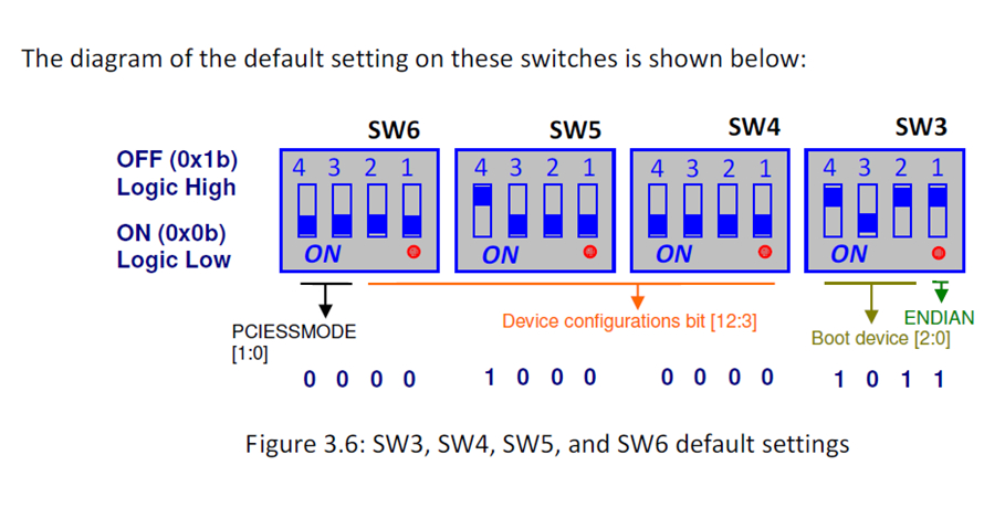

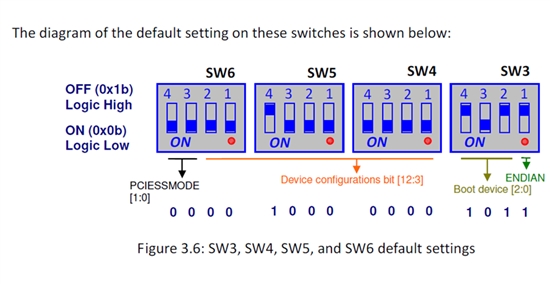

  • hello John;
    i noticed that the switched in both boards are different , so can you tell me the wright positions of the switches , it may be the reason ??
    thanks;
  • It's surely the reason.
    But I'm sorry I'm not at the office for now. But normaly you should have a document given with the board showing the right postion of the switches.
  • i searched in the user guide,Is that what you mean ??
  • Yes, it's exactly that
