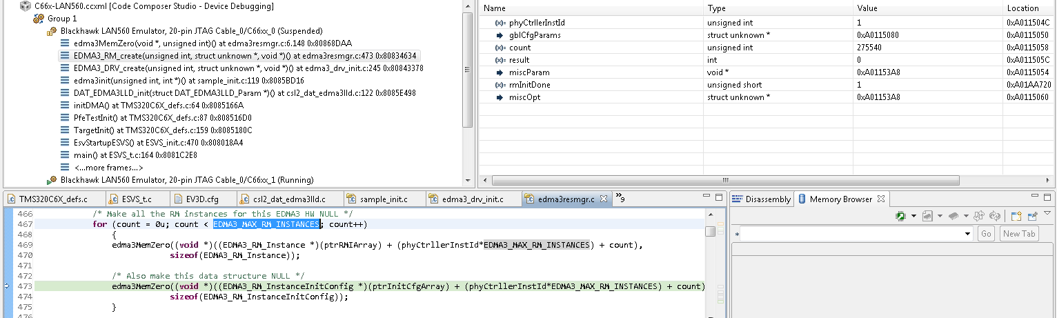

Endless spinning in EDMA3_RM_create when initializing EDMA3LLD with OpenMP enabled
When compiling our application with OpenMP enabled, the EDMA3-LLD fails to initialize - even when we are not using any parallel sections / code.
The initialization is done in strictly serial code, I am quite puzzeld why it fails - however it works perfectly fine when compiling with openmp disabled.
The hang occurs in edma3init():
EDMA3_MAX_RM_INSTANCES is some bogus uninitialized value.
As soon as uncommenting the openmp-specific parts of the cfg-file and linking against rts6600_elf_mt.lib instead of rts6600_elf.lib, the following code prints instead of 8 some undefined negative value:
extern const uint32_t EDMA3_MAX_RM_INSTANCES;
void initDMA() {
      printf("RM Instances %d \n", EDMA3_MAX_RM_INSTANCES);
I would be really grateful for ideas about what could be the issue here.
We are using cgt 7.4b2 with openmp sys/bios runtime 1.1.2.03_beta, and EDMA-LLD 2.11.5.
Thank you in advance, Clemens
  • I think this might be some kind of linker bug (or a really dubious problem).
    I was able to reduce the issue to a small, self-contained testcase - I have uploaded the project: 2465.OmpLinkTest.zip
    It would be really great if someone from TI could give it a try, to verify wether this is a real bug or rather a stupidity on my side.
    To compile without OpenMP, please do the following steps:
    - Uncheck the "Enable support for OpenMP 3.0" in Properties->Compiler->Advanced Options -> Advanced Optimizations
    - In Properties->Linker->"File Search Path" replace rts6600_elf_mt.lib with rts6600_elf.lib
    - Comment out the OpenMP related options in EV3D.cfg
    When the program is executed without OpenMP, it reports correctly:
    RM Instances 8
    With OpenMP support turned on however, I get
    RM Instances 0
    when running with the Simulator, or some undefined value on the EMV6678 - even although it doesn't use any parallel constructs.
    Thanks, Clemens

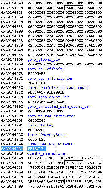

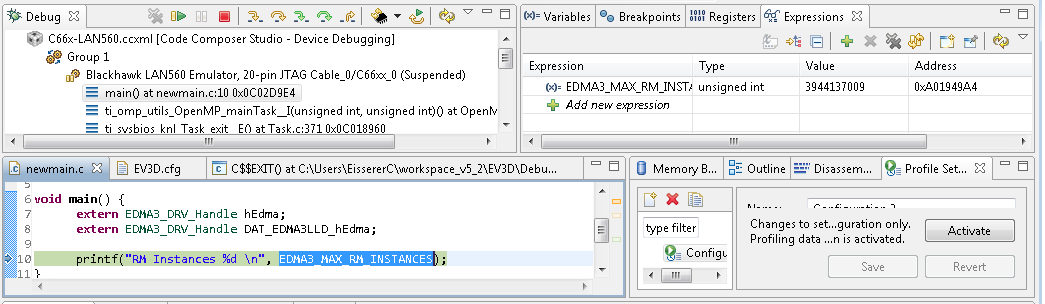

    EDIT: Just imported the project on my production system (different CCS 5.2 installation on a different machine), and was able to reproduce the issue on my EVM6678:
    [C66xx_0] RM Instances 1796653345

    I was able to reproduce the problem on simulator. I do see the value at address of EDMA3_MAX_RM_INSTANCES in MSMC_NOCACHE pointing to 0.  Since OpenMP runtime maps DDR address to MSMC using MPAX register and makes it non-cacheable, I am suspecting issue with MPAX functionality in simulator. I will get back to you on this after confirming from the simulator team.
    However on my EVM I do not see this issue even with the executable you attached. The same executable correctly over-writes the memory at EDMA3_MAX_RM_INSTANCES (0xA01949A4) with 8 after each load. Could you please verify the value at the register address. Also could you please provide the following information:
    • The bootmode for the EVM.
    • If you are using any gel file to configure the DDR.
    Yogesh

    Update: The issue seems to occur only at the first run, right after the evm has been cold rebooted:
    [C66xx_0] RM Instances -350306271
    [C66xx_0] RM Instances 8
    Thanks a lot, Clemens
    PS: I made some screenshots of the debugger to show you how the memory is initialitzed:

  • Hi Yogesh,
    I was able to find the problem - it was project related. The linker settings had initialization model = none set, which didn't seem to cause any problems with single-threaded code, but caused unreliable behaviour with OpenMP enabled. With initialization model = ROM, everything works as expected on my EVM.
    Glad that at least a Simulator-Bug was found through this mistake.
