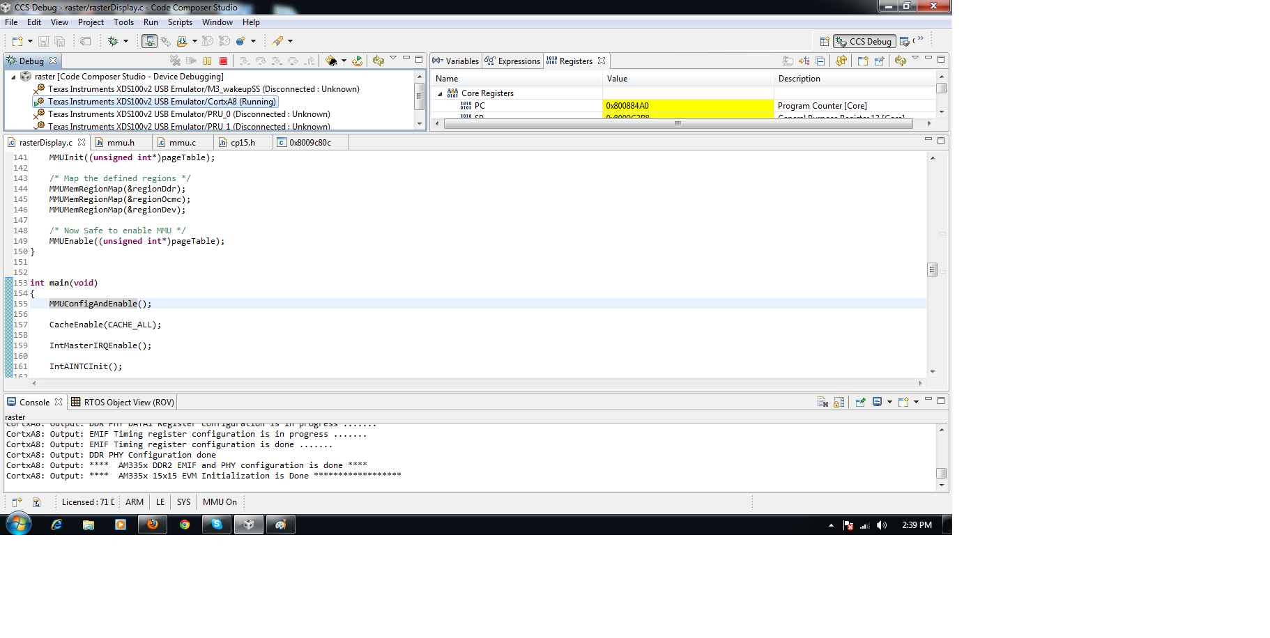

I am working on getting MMU working on AM335x, we have our own custom board (closer design to Beagleboard) with NAND flash
i am able to boot from NAND flash, now i want to use MMU in my code, i am using Codesourcery GCC ver 4.2.3 to compile my own written standalone code
i have used MMU code from Starterware (ver 02.00.00.06) code, but my code stops executing after CP15MMUEnable(); i have used all same code from starterware for MMU, i have verified pageTable address and also verified that entries in pageTable are correct
My code boots from NAND flash, then i copy my initial bootloader to DDR2 RAM at address 0x80000000 and then jump DDR2 for execution, (i want to enable MMU for whole DDR2 memory region) there are certain messages i sent to terminal through UART0, and my code boots up preoperly, but when i try to enable MMU, at CP15MMUEnable, it halts and does not send the characters to terminal after this instruction, am i doing something wrong?
My MMU pageTable address is at 0x83904000 which is 16K boundary aligned as instructed
Below is the code patch i am using to enable MMU, which is taken from starterware code

Please help !!!

  • Hi Sujith,
    thanks for looking into this...
    value for macro NUM_SECTIONS_DDR is 512, i also tried with value as 2, but same results
    and you are right, the code aborts when it execute  " MCR     p15, #0, r0, c1, c0, #0 " instruction, when i comment this instruction the code executes well as it doesn't  enable MMU this time.
    Also code is executing in system mode, so there should be no any issue in accessing CP15 register..
    Alankar

  • Hi Sujith,
    Finally i got MMU working in my code, the issue was, there was a default FAULT entry added for internal RAM region, and my stack memory was located in internal memory, so i added page table entry for internal RAM region and it worked...
    but after this i couldnt see performance difference after enabling MMU, i seen one of queries on e2e, and i found that i need to make DDR region as MMU_MEMTYPE_NORMAL_NON_SHAREABLE, after this modifications i could see 30x performance, that was really great...
    now i moved forward with my original bootloader, which has LCD interface, NAND flash interface, UART0 and some other GPIOs, i enabled MMU in this bootloader also, but i seen very strange behavior in lot of cases, my code got stuck at one place where i configure one GPIO pin to turn on LED on it, i added some delay before writing to GPIO_OE register and this time it does not stuck (very strange), now i have some characters displayed on screen (which was getting displayed properly before MMU enabled) now there is lot garbage data i see on LCD, so same code does not work after MMU enabled, so i made LCD RAM buffer area page as MMU_MEMTYPE_NORMAL_SHAREABLE and then i see proper characters on LCD, now i have NAND flash write function which was working properly before MMU enabled and now after MMU enabled its getting stuck in between, i tried further on this and i found that when i enable DCACHE then i see such type of issues, if i enable only ICACHE, i dont see lot of issues (still there are some, and i have to compromise on performance which i dont want), but after enabling D and I CACHE, its forcing me to debug a lot to workout my original code which was previously working, and i am not comfortable in adding delays at some places and get it to work
    I have not worked too deep with MMU, and in our product we do not have any operating system, we have our own os written in some sort of assembly and C, am i missing something while configuring the MMU, do i need to do cache flush or such sort of operations in code. i didnt see such major issues with old MMU (with ARM926ejs)
    i am really facing such lot issues with my working code after the MMU is enabled, Can you please help me with this, i am really confused now
    Alankar

    ** Function to setup MMU. This function Maps three regions (1. DDR
    ** 2. OCMC and 3. Device memory) and enables MMU.
    void MMUConfigAndEnable(void)
        ** Define DDR memory region of AM335x. DDR can be configured as Normal
        ** memory with R/W access in user/privileged modes. The cache attributes
        ** specified here are,
        ** Inner - Write through, No Write Allocate
        ** Outer - Write Back, Write Allocate
        REGION regionDdr = {
                            MMU_PGTYPE_SECTION, START_ADDR_DDR, NUM_SECTIONS_DDR,
                            MMU_MEMTYPE_NORMAL_NON_SHAREABLE(MMU_CACHE_WT_NOWA,
                                                             MMU_CACHE_WB_WA),
                            MMU_REGION_NON_SECURE, MMU_AP_PRV_RW_USR_RW,
                            (unsigned int*)pageTable
        ** Define OCMC RAM region of AM335x. Same Attributes of DDR region given.
        REGION regionOcmc = {
                             MMU_PGTYPE_SECTION, START_ADDR_OCMC, NUM_SECTIONS_OCMC,
                                                              MMU_CACHE_WB_WA),
        ** Define Device Memory Region. The region between OCMC and DDR is
        ** configured as device memory, with R/W access in user/privileged modes.
        ** Also, the region is marked 'Execute Never'.
        REGION regionDev = {
                            MMU_PGTYPE_SECTION, START_ADDR_DEV, NUM_SECTIONS_DEV,
                            MMU_MEMTYPE_DEVICE_SHAREABLE,
                            MMU_AP_PRV_RW_USR_RW  | MMU_SECTION_EXEC_NEVER,
        REGION regionNAND= {
                                MMU_PGTYPE_SECTION, 0x10000000, 512,
                                MMU_MEMTYPE_NORMAL_NON_SHAREABLE(MMU_NON_CACHEABLE,
                               		 MMU_NON_CACHEABLE),
        /* Initialize the page table and MMU */
        MMUInit((unsigned int*)pageTable);
        /* Map the defined regions */
        MMUMemRegionMap(&regionDdr);
        MMUMemRegionMap(&regionOcmc);
        MMUMemRegionMap(&regionDev);
        MMUMemRegionMap(&regionNAND);
        /* Now Safe to enable MMU */
        MMUEnable((unsigned int*)pageTable);

        MMUConfigAndEnable();
        CacheEnable(CACHE_ALL);

    I am also getting same problem  for BeagleBone (Rev6), I am trying to run SYSBIOS rasterdisplay.c on BeagleBone but during debugging it is stoping in main function at this statement " MMUConfigAndEnable()".
    Here i am attaching image with status of the A8 processor, when cursor is at   MMUConfigAndEnable()  while debugging with step over in CCS v5.3
    I have traced with  PC address(which is present in above image), it is showing function  "MMUInit((unsigned int*)pageTable);" present in MMU.c
    Can anyone Please help me how to solve this MMU enabling issue............
