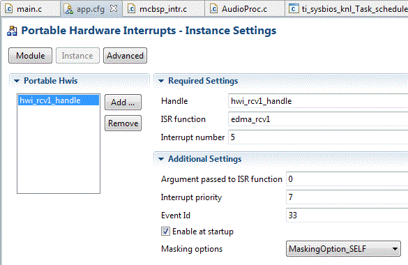

  • Hi Steven,
    Yes, we need to generate EDMA3 completion interrupt to CorePac.  I used Event Id = 33 and my edma_rcv1 ISR did not get called.  I looked at Table 7-33.  33 is QM_INT_LOW_1, that is not EDMA3_CC_GINT.    Table 7-34 has EDMA3_CC_GINT = 22.   Could you tell me what are the settings for the configurator page?  I am quite confused by the documentation about this simple page, see below.
    Thank you.
    Steve
  • Steve,
    Sorry for that I looked at the wrong data manual. You are right that  it should be event 22 for EDMA3_CC_GINT in 6657. But the event number is the system event input number for CIC0. You need to map the system event to CIC0 host output, which is the input to CorePac INTC. So it is two-step procedure.
    I think the BIOS page you are showing is for CorePac INTC (HWI) only. The interrupt number could be 4-15 (5 in your example). But the event ID is the input to CorePac INTC (event number in Table 7-33), not the system event number in table 7-34. For example, if you choose to map system event 22 (EDMA3_CC_GINT) to CIC0 host output 40, then you can use event ID 56 in this page, since CIC0_OUT40 is event 56 for CorePac (table 7-34).
    You may need to setup both of the CIC and CorePac INTC your case.
    There is one wiki page talks about the interrupt setup in C66x devices.
    http://processors.wiki.ti.com/index.php/Configuring_Interrupts_on_Keystone_Devices#CpIntc
    But it is mainly for the C code part in BIOS.
    I am not familiar with BIOS CFG setup. If you would like to use the CFG page instead of C code, you may get quicker response when posting the question on BIOS E2E forum. Hope it helps.
