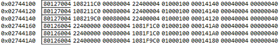

    The following is EDMA3 PaRam settings:
    Then, I call:  result = EDMA3_DRV_enableTransfer (hEdma, tx_chId,  EDMA3_DRV_TRIG_MODE_EVENT);
    result is 0.  But nothing happens, no change in the PaRAM.

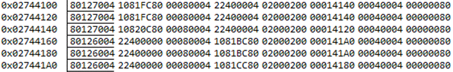

  • Set it to incremental mode for both TX and RX.  You're doing a 4-byte transfer and you need to fill the 32b register with the data.  With the Destination Index Increment set to -4, it should snap back to the same spot.
    -Chad
  • When I set BIDX = -4.  The address actually descrements, does not snap back to the same spot.
    Also, with PaRAM settings below, both source and destination address do not increment, as expected to.
    It seems EDMA did not transfer data to McBSP, because DRR and DXR do not change.
    Thanks.
    Steve

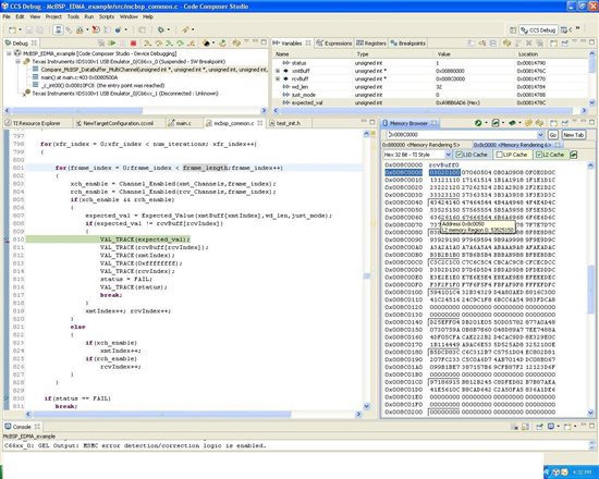

  • Hi Steven,
    Thanks for the infomation and example code.  I ran the example code and found the following.
    The transfer only happen once per power cycle.   Here is the procedure:
    power cycle,
    load code and run, transfer works (rx buffer changed to tx data) for none FIFO; transfer also works  for FIFO.
    restart and run, transfer doesn't work, rx buffer stays all zero.
    What might be the problem?
    Thank you.
    Steve
  • Hi Steven,
    After more testing, 4555.McBSP_EDMA_example.zip code only work by running from Restart to finish.  If stepping through, tx buffer to rx buffer copy will not happen.  And also, the board needs to be cold reset to work again.
    Your explanation is appreciated.
    Thank you.
    Steve
  • Steve,
    Have you loaded the C6657 GEL file to do "Global Default Setup" to initialize the EVM please?
    Another possibility is that  there could be some residue in EDMA/McBSP setup with L1D/L2 cache enabled, which requires the reset for put the EDMA/McBSP into default states.
    So I added some code in the beginning to disable L1D/L2 cache in the example and I tried the output file on C6657 EVM that it could be re-run without cold reset or even hot reset. Please give a try on the attached example.
    1106.McBSP_EDMA_example.zip

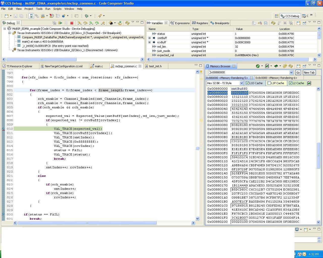

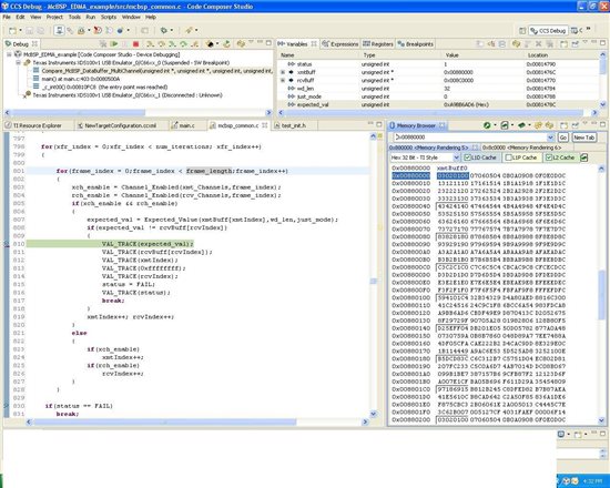

  • Hi Steven,
    Sorry for the delay.  I was on vacation last week.
    I tried your 1106 code and it worked pretty much the same way.  After more testing, I discovered the following:
    With a fresh start, I can repeatedly run from startt to finish (restart after each run) without problem.
    If I set break point in or immediately after these code, then system needs to be cold started to operate correctly again.  Note: ipr.intrh become 0x00A0, not 0x00F0.
             Tx_Rx_Clkgen_Frmgen(hMcbsp[0], MCBSP_ENABLE);   /*Enable TX, RX, SRGR clock and SRGR Frame generation */
            Tx_Rx_Clkgen_Frmgen(hMcbsp[1], MCBSP_ENABLE);
             VAL_TRACE(0x99990000);
             do  {
                            CSL_edma3GetHwStatus(hModule, CSL_EDMA3_QUERY_INTRPEND, &ipr);
             }  while(ipr.intrh!= 0x000000F0);
     Thank you.
    Steve
  • Steve,
    I think it is due to the emulation mode in McBSP. By default, the FREE and SOFT bits in SPCR register are 0s. The McBSP TX/RX will stop immediately when you reach the breakpoint (an emulation suspend event). Then the EDMA channels will not be triggered by McBSP events, so the flag checking (ipr.intrh) is stuck.
    If you want to keep McBSP running during emulation event, you can set FREE bit to 1 in SPCR register during the McBSP initialization. Please refer to section 2.16 in McBSP user guide for emulation details.
    You can make the change in the example and let us know if it is working for you.

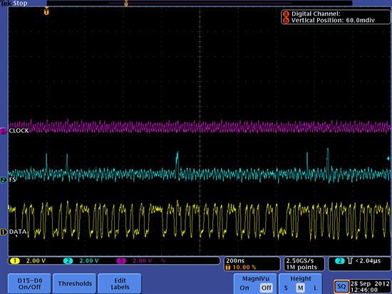

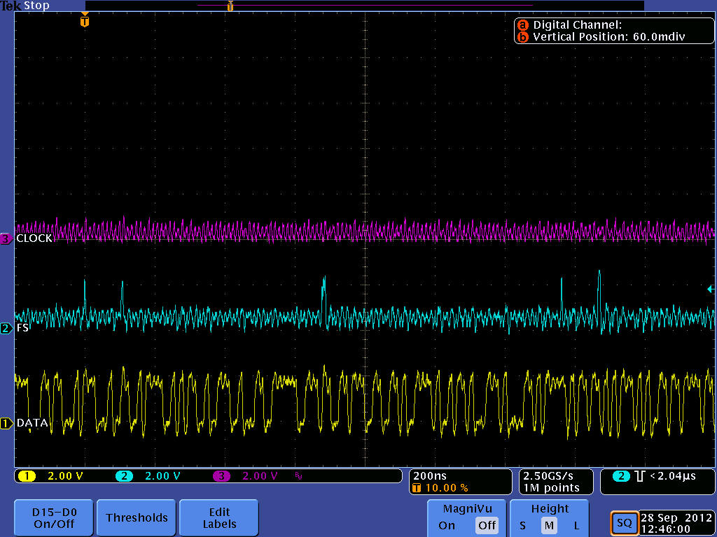

  • Hi Steven,
    The EMDA3 and McBSP seemed work fine with your sample code.   I am try to look at the signals on McBSP lines at TEST_PH1 connector, pin 76 (Tx data), pin 72 (FST) and pin 66 (TXCLK).  The data looks good.  But the frame sync and clock seem has contention.  See scope capture below.
    Thank you.
    Steve
  • Hi Steven,
    I found the problem with the issue above.  TMDXEVM6657L's FPGA is contenting with clock and frame sync.  We need to configurate FPGA registers that are accessed through SPI.  Do you have sample code to read/write SPI on C6657?
    Thank you.
    Steve

  • This code is not halting now. But the result is fail. I need to debug. The buffers looks like fine. However the result is fail. I shall try some more.
    What needs to be done to make this ping-pong continuous (infinite). And read proper buffer (ping/pong buffers).
    Hari
  • OK, in between the data is zero in the rcvBuffer.
    That's why compare fails.
  • Hari, it looks like you only transfered half of the buffer.
  • Upto rcvBuff[0x008c0120] the values match with TxBuf.
    From rcvBuff[0x008c0120] to rcvBuff[0x008c0140] all values are ZEROS.
    Then again there is a match from 0x008c0140 to 0x008c01a0
    Again there are some zeros. Again it matches. So in between it writes ZEROS.
    The total is 128 * 4 bytes = 0x200 locations. It has done one transfer.
