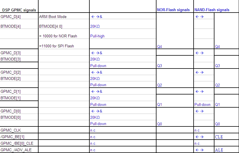

Hi all,
           If the product is a DVR, NOR Flash (16bit) is the code booting,
          and record images using NAND Flash (8bit), the circuit should be how to connect? Thank you

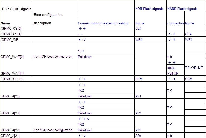

  • Hi biser,
                    Thanks you reply.
                    Could  you tell me the refer to table 4-2 and 4-3 in what document?
                    Could you help to check the following table connection is correct? Thank you.

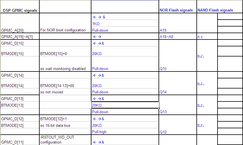

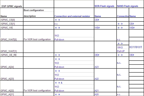

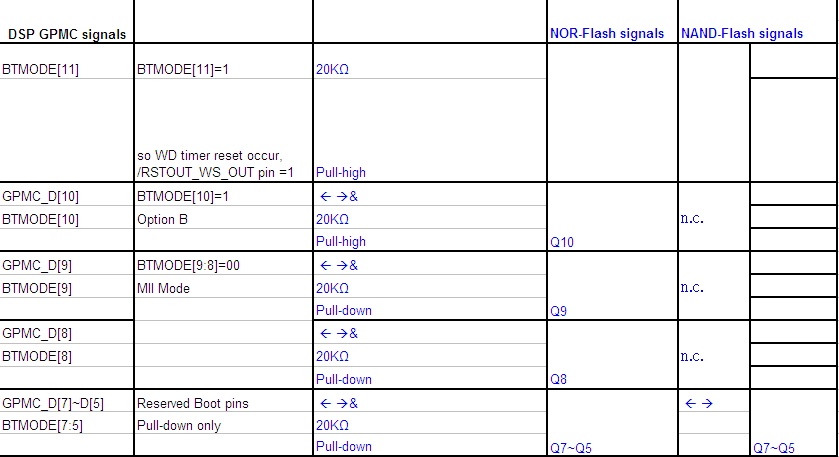

  • Hi Huang,
    A few notes from me:
    • NAND signal CLE should be connected to GPMC_BE[0]_CLE
    • GPMC_WAIT[0] should not be pulled down externally. This will cause the processor to wait forever.
    • Please read carefully "Advisory 2.1.33 XIP Boot: High-Order Address Handling (GPMC_A[27...13])" in the DM814X Errata. It can be found on the TI product page, and here is the link: http://www.ti.com/lit/er/sprz343a/sprz343a.pdf. You can refer to Page 28 of the EVM I/O Expansion board for reference to the workaround. I suppose this is the reason you placed all those 1kOhm external pull-downs on the high address lines.
    • Also don't forget to take into consideration the DM814X internal PU/PD resistors, which are enabled by default and can be reconfigured when the pinmux registers are set at U-boot time.
    Other than the above notes the connections look OK to me.
    Best Regards
    Biser

  • Hi Huang,
    1. Tables 4-2 and 4-3 are on pages 155-157 in the DM814X datasheet (http://www.ti.com/lit/ds/symlink/tms320dm8148.pdf).
    2. Yes, this is the TI proposed workaround. I'm not sure, but 1kOhm pull-downs may be too strong and draw excess current when trying to drive these address lines high.
    3. This is correct for processor silicon version 2.0. Anyway, I don't think it will hurt if you provide an external pull-down. You can always remove it if it causes a problem with accessing NOR.
    Best Regards
    Biser
  • Hi Biser,
    Sorry, I'm a little confused, then GPMC_WAIT0 the follow connection the EVM EXP_IO_BOARD circuit design to the NOR Flash RY/BY and pull-up 10kohm or follow technical reference manual the will GPMC_WAIT0 pull-down? Could you help to confirm this? Thank you.
  • Hi Huang,
    First of all, does the NOR Flash (which you intend to use) have a RDY/BY signal? If it does, I think it will be wise to connect it to GPMC_WAIT0. RDY/BY may not be needed for reading from the NOR (read accesses are usually much faster than writes), but you may want to reprogram the Flash on-board, and then you will definitely need the RDY/BY signal. If you are not sure, I can suggest you provide place for a pull-up on this line next to the Flash, then a 0Ohm serial resistor, and after it place for a pull-down next to the processor. This will allow you to configure all possible connections without having to cut traces and patch components on the board.
    Best Regards
    Biser
