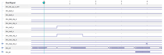

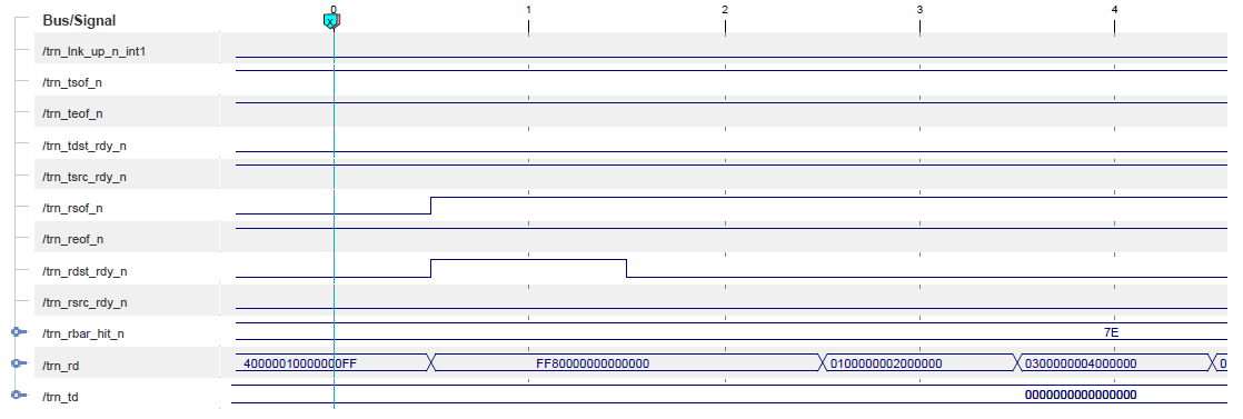

  • I have since managed to insert ICON and ILA cores into the FPGA to observe signals associated with packet transfer. I have also now successfully seen evidence of a data packet transfer into the FPGA's user application corresponding to a memory write request. This began after I managed to configure the FPGA's BAR address to teh correct value (matching its memory request size):
    I also observe correct signal transitions and header field values for memory read requests however data is still not received by the DSP:

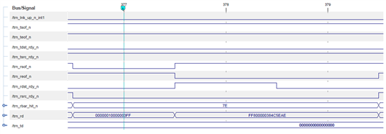

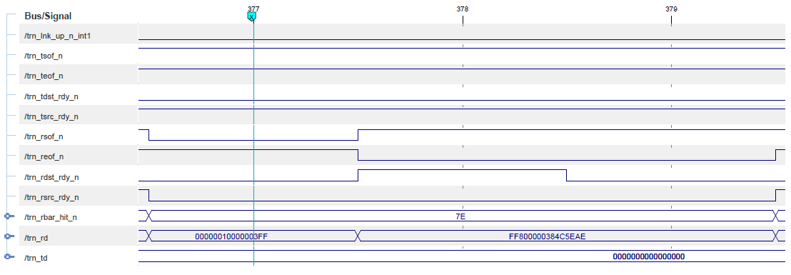

  • I have now successfully observed a read request completion with data, and been able to view the data in the DSP DDR using the CCS memory browser:
    However this was somewhat by accident as I experimented setting the data size I wanted to write and read to 65 (2x 32 DWORD + 1x 1 DWORD).
    As you can see, the 1 DWORD request is completed by the FPGA whereas the 32 DWORD requests go unfulfilled.
    I am using EDMA to perform both read and write. Write requests are executed fine with the data payload following the TLP header.
    I have performed EDMA transfers between 2 C6678 in the past without this happening.
    Does anyone know how to solve this problem?
    Does the EDMA module need to be stalled before its next read request?
    or is it a problem with the FPGA not being able to reply to request greater than 1 DWORD?

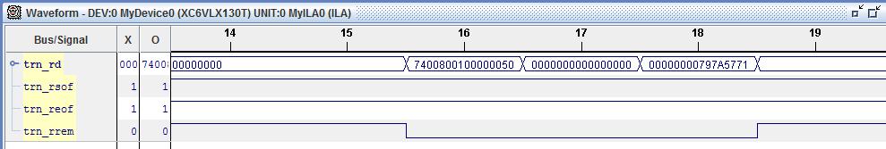

    But I am having problems when transfering data. I am receiving in the trn_rd bus words that I didn't expected. When reading the PCIe standard specification, I have found that the data I receive is a kind of message request. Another thing I see is that trn_rsof_n and trn_reof_n don't activate, and I have seen that you had that problem too. Can you tell me how did you solve your problems with data transfering?
    Here is attached an image with the message received:
