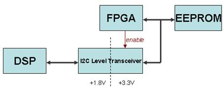

The I2C EEPROM is into a +3.3V environment. There is two I2C masters: First is an FPGA (direct connection), and second is an I2C Level Transceiver +1.8/+3.3V (PCA9306DCTT) connect to DSP. The transceiver enable pin is controlled by FPGA. FPGA is fully under our control.
During boot-up sequence (but also before and after), we verified and we are sure that the FPGA drive nothing (Keep Hi-Z) and transceiver is enabled and do not toggle.

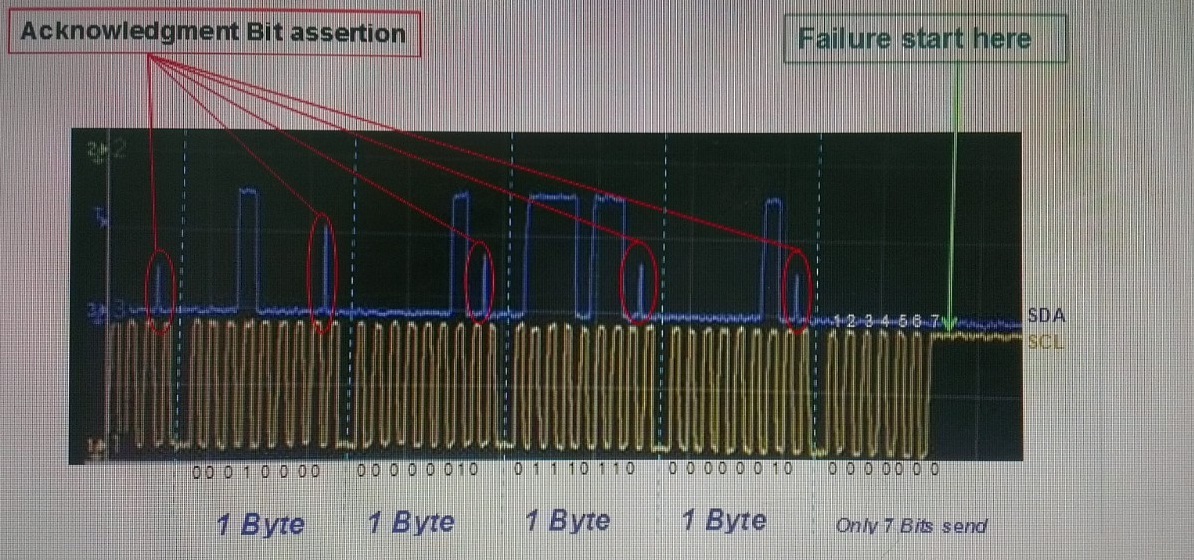

    Sure we have (sorry for the quality, it is a screen capture):
    as the capture shows, the error happens when the DSP reads 7bits on the last byte try (Should be 8bits data+1bit ack). As no "stop condition" is sent by the DSP, the EEPROM just wait the DSP pulse one more clock period to send the bit-8; Then it lock the I2C lines.
    This error happen suddently during a sequential read phase, after many bytes already sent before...

    Please provide a zoomed capture of just the last SEEPROM read and show the SCL and SDA for both the 1.8V and 3.3V circuit portions.  You will need to capture all 4 channels on a single scope capture.  Take care to clearly set the ground level for all 4 probes so that the voltage levels are clearly readable.
    Tom

    I will do my best to try to capture this event (Not happen that often actually).
    What I can say is that we already tried to do so, and nothing special had been noticed : the +3.3V side and +1.8V side had the same shape. By the way, the third channel of the scope (I remove it from the capture) probe the "enable" pin if the transceiver. It remains active all the time (and without glitches).
    The provided waveform shows signal on the EEPROM's pins. Do you have any concern about FPGA driving something or transceiver issues?

    I am concerned with levels and timing.  Precise scope captures are needed.  The one provided is insufficient.  You should be able to setup your scope trigger to look for this stall when clock stops toggling for more than a maximum time period.
    Tom
