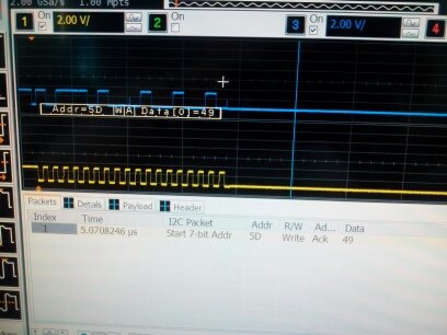

       we use the DM648 as a slave to communicate with an ARM through the I2C, and the rate is 100kbps. However, sometimes the I2C of DM648 will not send the ACK bit to the ARM(Figure 1 below). this problem is very serious when arm send data to DM648 often(for example , every300ms). what causes this and how to solve it?
  Figure1  the wave on the SCL and SDA(yellow--SCL, blue--SDA)

    Other than the display from the I2C protocol analyzer, what indication do you have of a problem? Does the write operation complete successfully? Does the ARM report a problem?
    What signal level do you expect the ACK bit to have? The blue SDA waveform in your picture shows a logic level of 0 during the final SCL clock pulse when the ACK/NACK bit is expected.
