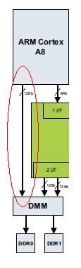

    But if I do memset on a big memory area(for example 1 Mega bytes) in any other
    thread on COTEX-A8, the data flow will block, and the application will not exit when press ctrl+c.

    There is a way from A8 to DMM directly. So continuous writes from A8 may occasionally starve other requestors for DDRbandwidth. So we don't recomend to use memcpy or memset at A8 side if the size is bigger than 1kB. Pls try to use EDMA to do that.

    1.  When DMM worked in non-interleave mode, the issue exists.
    2.  When DMM worked in interleave mode, it seems the memset will never cause the issue.
    3. Appro works fine even in no-interleave mode.
    and rsz stop trigger the interrupt when the stream blocked.
