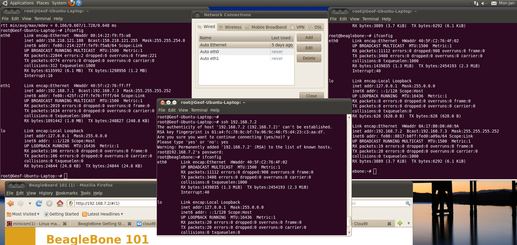

  • IMHO you want to use USBnet (as Linux describes it) documented here (with references to RNDIS): http://www.linux-usb.org/usbnet/
    This is nicely available on Beaglebone basically the following commands referenced here: http://beagleboard.org/static/beaglebone/latest/README.htm under “Launch USB-to-Ethernet interface” and in the attached screen shot.  The left Terminal Window is the Ubuntu laptop showing the TI network IP address on eth0 and the USBnet local address on eth1 of 192.168.7.1.  The right Terminal Window is the Beaglebone also showing the TI network IP address on eth0 and the USBnet local address on eth1 of 192.168.7.2.
    Towards the bottom left you can see the Beaglebone serving up a web page (from Firefox running on Ubuntu laptop) since it is running an HTML server on its 192.168.7.2 local address (The middle terminal window just show an SSH login to the Beaglebone USBnet address so that CCSv5 RSE can eventually be used: http://processors.wiki.ti.com/index.php/How_to_setup_Remote_System_Explorer_plug-in ).
