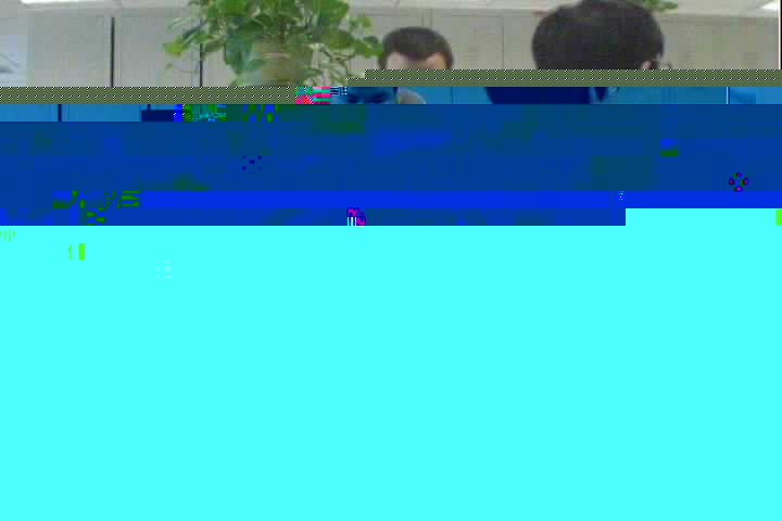

When we use cmem memory and CacheMng_MemCpy(),or use the system memory and
memcpy(),the save jpg file is ok.But use the system memory and
CacheMng_MemCpy() just as the above code,the save jpg file is wrong ,just as
follows pic:
The first half of snapbuf have valid data ,and the second half value are all 0.
Is CacheMng_MemCpy() only use cmem memory?
