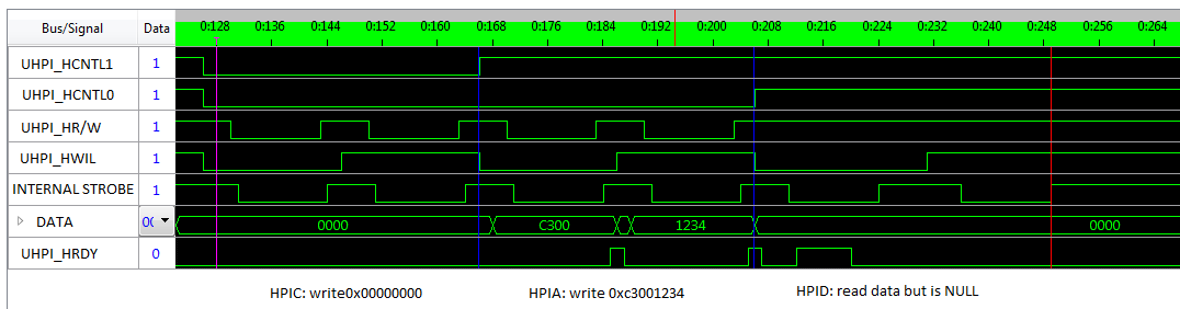

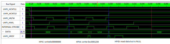

  • New updates
    Despite signals look right, I can't still access to data.
    these are the output signals.
    UHPI_HCS always low
    UHPI_HDS2 always High
    UHPI_HDS1 is the internal strobe signal.
    UHPI_HAS alaways high.

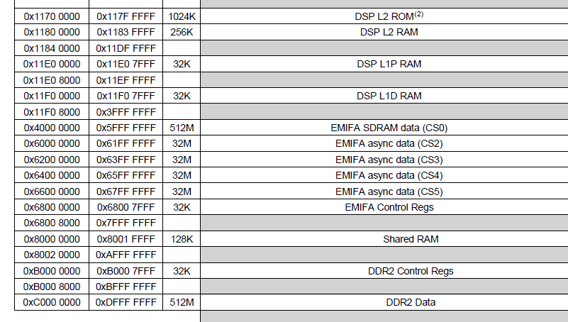

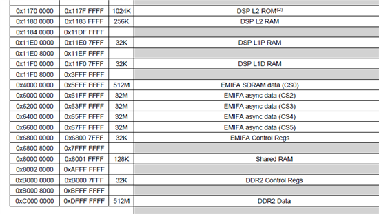

    this is memory mapping for omap l138 pag 25 on sprs586d.
    On my board are installed 128M Ddr ram, so it can be addressed from 0xc0000000 to 0xc8000000.
    I tried to read and write in any memory address (DSP L2 Ram, DDR2, other register...).
    Is there any memory address that is not accessible from the host port?
    must Dma logic be have some different privileges level?
    thank you.
  • Hi
    You should not have issues accessing the DDR2 or DSP L2 memory, unless you have a software or hardware issue.
    Perhaps see if the long discussion in this thread provides any clue
    http://e2e.ti.com/support/dsp/omap_applications_processors/f/42/p/88737/320381.aspx
    There are some registers maps like the SYSCFG etc, that cannot be accessed by HPI, as they can only be accessed in privlieged mode, which UHPI does not have, however memory accessess should work.
    I am assuming there are no issues with your DDR2 memory and initailzations and that you are able to access DDR2 memory with simplar ARM/DSP side functions, just not UHPI, correct?

  • Hi Mukul
    your answer is correct... I can access on DDR2 and L2 Memory, but i can't recive data from Hpi.
    And no clue in the your discussion...
    If someone used HPI interface, can copy the code?
    Thanks a lot.
