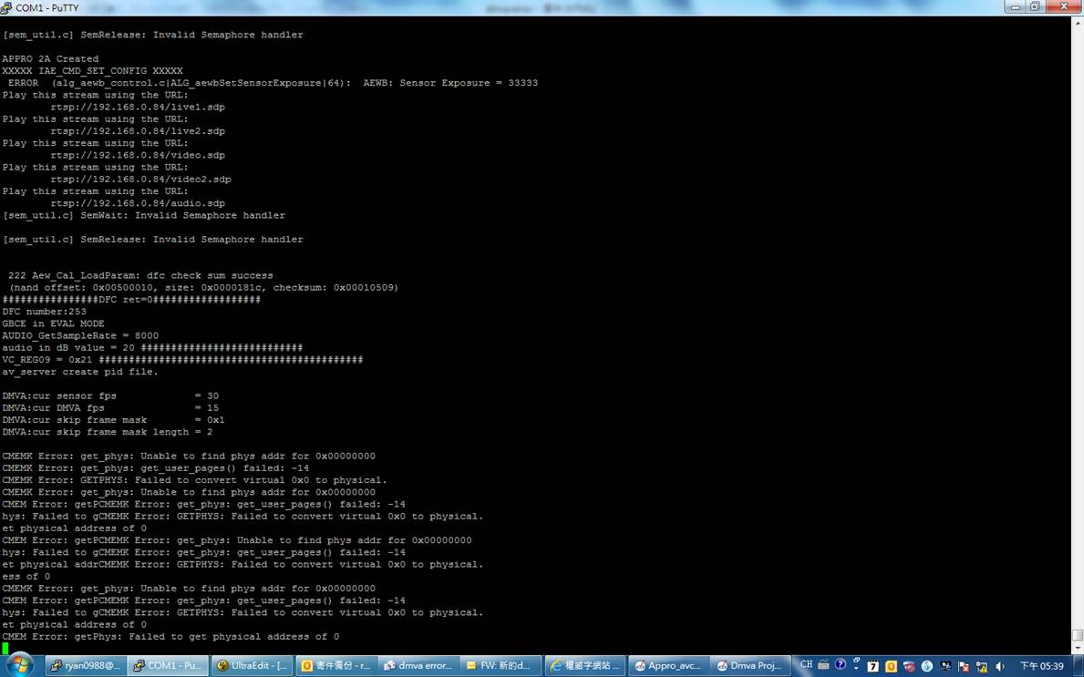

i got CMEMK errors in consloe

    2. About CMEM errors, i don't know how to debug on this.
    Can you give me a hint or a way to debug on this, i will try.
     i google that i can trun this on to debug CMEM error
    var CMEM = xdc.useModule('ti.sdo.linuxutils.cmem.CMEM');
    CMEM.debug = true;
    when i add this to alg_server.cfg
    i got an error
    can't find the library 'lib/cmemd.a470MV.
    It seems i only have cmem.a470MV file, i dont have cmemd.a470MV.
    How can i get cmemd.a470MV this file?

    2.Does SMETA algorithm work fine without CMEM errors?
    Can you take CE_DEBUG log to find out if the CMEM errors are coming from any of the DMVAL kernels?

    2. SMETA algorithm had CMEM error, too.
    How do i get CE_DEBUG log ?
    ryan

    2. You set trace and debug options to true in alg_server.cfg file and run av_server.out as - CE_DEBUG=3 ./av_server.out <options>
    regards,
