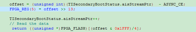

I'm trying to build a project about TMS320C672x secondary boot from parallel flash with GPIO lines used for extending the address range of Flash.
The connection between DSP and the flash is as follows:
The flash data bus is 16-bit. The A14 to A21 are connected to DSP UHPI.HD[0] to HD[7].
Here is my problem :
I program the flash page change code like"GPIODAT1 = offset >> 15" in the TISecondaryBoot.c, then I burn it into the flash, it does not work.
Should I use PAGE_SWAP_COMMAND to change page? And how to use it ?
Thank you very much!

  • hello David,
    Thanks for your reply!
    I have read the boot loader application notes and downloaded the example code in sprc203.zip.
    But I'm a little confused about the example in the folder "sprc203\TMS320C672xxBootUtils\TMS320C672xxBootUtils\TMS320C672xxBootUtils\Examples\generic\gpio".
    I want to write the secondary bootloader  in C language rather than assembly language.
    So, I modified the file "TISecondaryBoot.c" and added flash page change code "GPIODAT1 = offset >> 15" in the according to the connection. Somehow, like the FPGA to change the flash page in the file “TISecondaryBootPADK.c” .
    Then, I used genBootcfg.pl to generate myapplicationcfg.c and myapplication.cfg.
    Finally, I used genAIS.pl to generate myapplication.ais.
    Because I do not use the command "PAGE_SWAP_COMMAND ", the genAIS script is -i myapplication.out -o myapplication.ais -bootmode raw -pf 16 -cfg myapplication.cfg.
    I do not know where  the mistake is? Do I misunderstand something?
