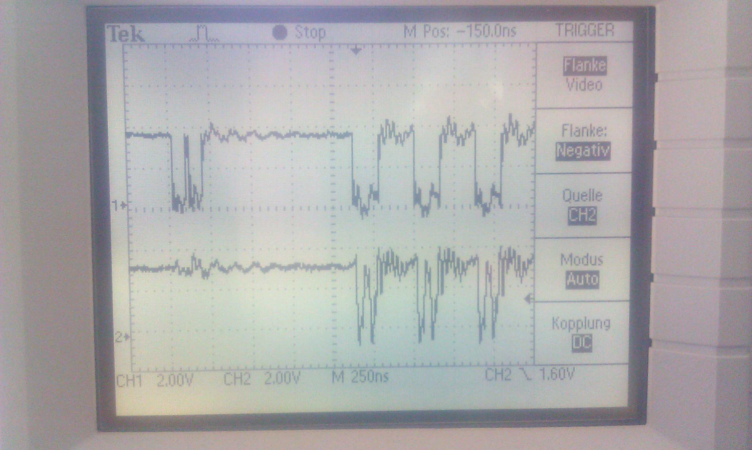

I've got a A/D converter connected to a DSP6747 device (B; Rev. 2.0), configured to asynchronous R/W, CS4
At some point I wondered why my interrupt routine accessing this converter at 500kHz consumes such CPU load.
Some data on the configuration:
100 MHz bus clock (confirmed on pin), 300 MHz DSP clock (consistent with NOP delay time)
CS4 with 1-3-1- timing, WAIT disabled, normal mode
No SDRAM or Flash at this interface
The answer came looking at the bus with an oszilloscope within a simple test: endless loop with 16 or 32 bit accesses to the interface (6 accesses within the loop, no asm instruction between the 6 reads/writes).
every read access is followed by 200 ns  to 220ns of silence on the bus, basically:
16 bit read: CS low -> 10ns later OE low -> 30ns later OE back -> 10ns later CS high -> 220ns break!!! -> CS low ...
32 bit read: CS low -> 10ns later OE low -> 30ns later OE back -> 20ns later OE low-> 30ns later OE back -> 10ns later CS high -> 220ns break!!! -> CS low ...
The funny thing: write accesses are not affected!
16 bit write: CS low -> 10ns later WR low -> 30ns later WR back -> 10ns later CS high -> 20ns break -> CS low ...
32 bit read: CS low -> 10ns later WR low -> 30ns later WR back -> 20ns later WR low-> 30ns later WR back -> 10ns later CS high -> 20ns break -> CS low ...
Something inserts a 200ns delay after each read access. I checked, as far as I could, all possibilities:
NAND is disabled
WAIT is disabled
EMIFA powerdown is disabled
Power controller? Would probably switch the whole thing off completely...
Bandwidth controller? But there are nothing but L1PRAM accesses and EMIFA.
Asynchronous bridge? OK, some delay but 200ns for a 300MHz / 100MHz bridge?
Error Registers? empty!
Interrupts? Disabled except NMI
The impact of this effect is severe! A connected ADS8556 cannot be read within the timeframe between two conversions (700ns @ 500kHz), reading these values takes 800ns and therefore 40% CPU load!!!

  • I only have an old, crappy scope at hand, sorry for only providing a cellphone image.
    Timing is 2-4-2-2 (Setup-Strobe-Hold-TA) @100MHz on this image.
    On the left, there are two 16 bit write access cycles, following each other directly. (which works)
    On the right, there is the result of three read access cycles triggered by three LDW CPU commands (which have the 200ns in between in which the CPU is stalled).
    Upper trace is CS4, lower trace OE (and the probes were very crappy)
    Another company working a lot with C6xxx CPUs confirmend the behaviour and suspect the complex data path structure (and many bridges) to be responsible for the delays.

    It seems, since it is a packet-based switching matrix in the DSP, that the following delays are 'normal' (C6747@ 300MHz / 150MHz Matrix / 100MHz EMIFA):
    Event-> DMA transfer (bus free) 250ns
    DMA second burst (AB Transfer): 80ns
    CPU read on EMIFA, 32-bit: 350ns (CPU stalled!!!; @ EMIFA 1-3-1 timing)
    CPU write: ? (probably cached, no delay)
    Since the company who designed the hardware gave the ADS8556 only two addresses for the read register, I need to program the DMA to have 3 Bursts(B) of 32-bit / 4 Byte (A) with no B source increment (constant addressing mode not supportet by EMIFA), therefore it takes 250ns+100ns+80ns+100ns+80ns+100ns (1-3-1 timing on EMIFA for the ADS8556->100ns for 2x16 bit). So even if the bus / switching matrix is completely free, it takes 700ns to read the AD converter by DMA, much longer by the CPU. Since the converter is supposed to be driven with 500 kSps or more and needs 1,26µs for a conversion, there is only a 50ns gap under ideal circumstances.
