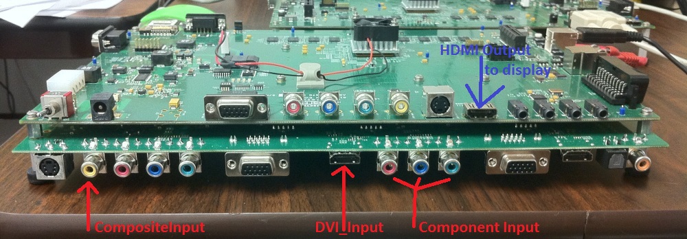

Hi, I'm having some trouble getting the various video inputs (SD or HD) on the dm816x_evm expansion i/o daughter card to work = i.e. the McFW demo app is not able to 'detect' any video sources.
So far, I've re-targeted ‘DVRRDK_V03.00.00.00’ at the dm 816x_EVM (via Rules.Make) and can boot the built kernel, load the M3 firmware (vpss and video) and accompanied A8 ko’s so that I can 'run' the mcfw cmd-line demo (/opt/dvr_rdk/ti816x/bin/dvr_rdk_demo_mcfw_api.out) that works on the DVR-RDK board.
./init.sh ; ./load.sh ; ./run.sh (--> ./bin/dvr_rdk_demo_mcfw_api.out)
Output on the command line seems to indicate that everything (M3fw, ko, program) loaded and is running correctly, and the monitor connected to the HDMI-out (not the daughter card) display shows the “Texas Instruments” overlay (i.e. the OSD generated by the C6x DSP) but I can’t seem to access any video inputs that I have connected to either D12 (composite input via NTSC camera), HDMI IN2 (DVI video via DVI camera) or [D6, D7, D8] (component in via another 8168_evm board demo running the OMTB video demo).
I assume that I need to modify a driver of some sort to gain access or 'map' to the correct video inputs sources on the EVM. Perhaps someone here can help? Ideally, I would like to get 1xDVI (HDMI_IN2 on the EVM) and 1xNTSC_composite video inputs working.
