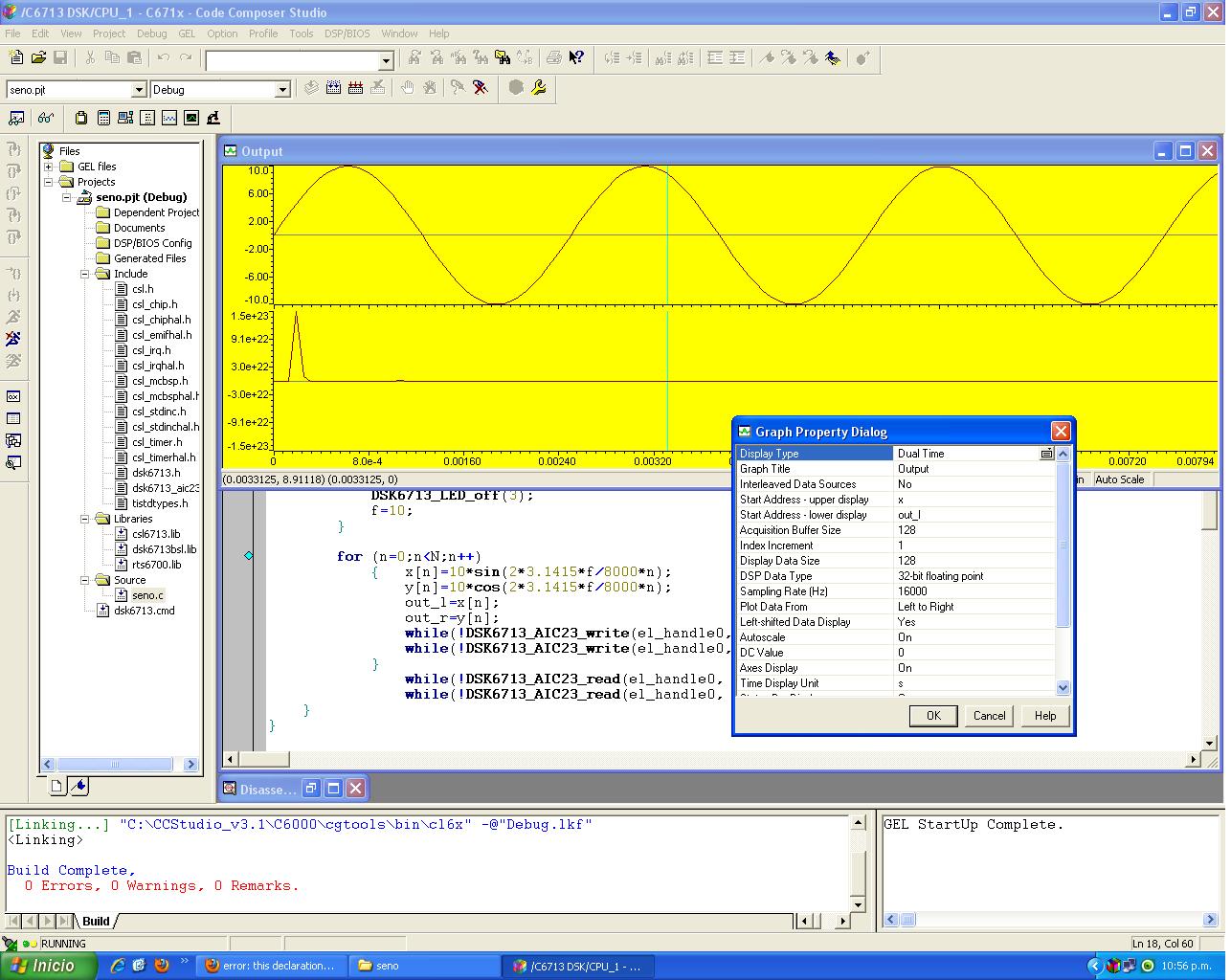

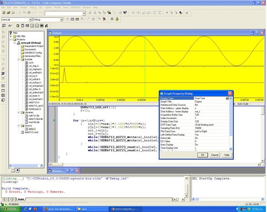

Hello.... I'm trying to generate a signal wave and sending through the line out of the DSK and i made a bridge between line out and line in to graph if the wave is correct but didn't work... the output variable show a sine wave but input variable don't show anithing.... any suggestion????
#include <dsk6713.h>
#include <dsk6713_aic23.h>
#include <math.h>
DSK6713_AIC23_Config            el_config = DSK6713_AIC23_DEFAULTCONFIG;
DSK6713_AIC23_CodecHandle        el_handle0;
unsigned int    in_r,in_l,out_r,out_l;
int                n,N=1000,f;
float            x[1000],y[1000];
void main ()
    DSK6713_init();
    el_handle0 = DSK6713_AIC23_openCodec(0, &el_config);
    DSK6713_AIC23_setFreq(el_handle0, DSK6713_AIC23_FREQ_16KHZ);
    DSK6713_LED_init();
    DSK6713_DIP_init();
    while(1)
        if(DSK6713_DIP_get(0)==0)
        {    DSK6713_LED_on(0);
            f=50;
        else if (DSK6713_DIP_get(1)==0)
        {    DSK6713_LED_on(1);
            f=100;
        else if (DSK6713_DIP_get(2)==0)
        {    DSK6713_LED_on(2);
            f=200;
        else if(DSK6713_DIP_get(3)==0)
        {    DSK6713_LED_on(3);
            f=500;
        else
        {    DSK6713_LED_off(0);
            DSK6713_LED_off(1);
            DSK6713_LED_off(2);
            DSK6713_LED_off(3);
            f=10;
        for (n=0;n<N;n++)
            {    x[n]=10*sin(2*3.1415*f/8000*n);
                y[n]=10*cos(2*3.1415*f/8000*n);
                out_l=x[n];
                out_r=y[n];
                while(!DSK6713_AIC23_write(el_handle0, out_l));        //Left channel write
                while(!DSK6713_AIC23_write(el_handle0, out_r));        //Right channel write
                while(!DSK6713_AIC23_read(el_handle0, &in_l));        //Left channel read
                while(!DSK6713_AIC23_read(el_handle0, &in_r));        //Right channel read

    Go to the TI Wiki Pages and search for "c6713 workshop" (no quotes). We have archived training material that includes example labs, and I believe there is one that takes audio in and sends audio out. If you get that working, then you will know that you have the input configured right so the problem would be easier to build from there to your test case.
    Or there should be working examples that come with the DSK6713. Or there are a lot of DSP books that use the DSK6713 as an example board.
    RandyP
  • Thanks Randy.. I will try and let you know how it goes
