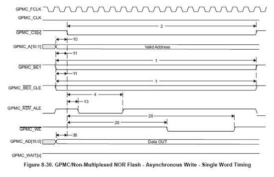

I have one question regarding AM3874's GPMC Data bus(GPMC_AD[15-0]) timing speicification.
Our customer connets the external ASIC to GPMC of AM3874. As you know, GPMC_AD signals are bi-directional.
So customer would like to know the maximum timing that  the ASIC may drive the data bus (GPMC_AD) line when the asynchronous read. Because ASIC's output signal may conflicts AM3874 address signal if this maximum value is not specified.
Please let me know  the maximum time that the external device may drive to the data bus when GPMC asynchronous read. Or please let me know the guaranteed time that AM3874 drive the GPMC_AD data bus to HI-z state.
