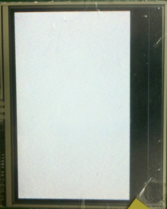

Hi everbody,
     I have a promble in developing the LCD  framebuffer driver on DM355. Our board is not the DM355-EVM. And the board is made by us based on the DM355-EVM, supporting for LCD output. The DVSDK version is DVSDK3.10, and the kernel is LINUX2.6.32. Our LCD screen is TFT320240-91-E.
     When I changed the bootargs to"mem=96M console=ttyS1,115200n8 root=/dev/ram0 rw initrd=0x82000000,15M ip=10.10.101.119:10.10.104.138:10.10.101.20:255.255.255.0:::off eth=00:01:02:03:04:06 video=davincifb:osd0=320x240x16:osd1=320x240:vid0=320x240x8:vid1=320x240x8 davinci_enc_mngr.ch0_output=LCD davinci_enc_mngr.ch0_mode=ntsc vpfe_capture.interface=1", boot the kernel, then the booting image can't incomplete display on LCD screen, as the first photo show.   The complete image should like the second the photo, when analog output( changed the red part in bootargs,to "davinci_enc_mngr.ch0_output=COMPOSITE" ).
       What are the reasons for incomplete display on LCD screen?   Any suggestions will be thank for !!
                                                               Fig 1  the first photo
                                                      Fig. 2   the second photo
