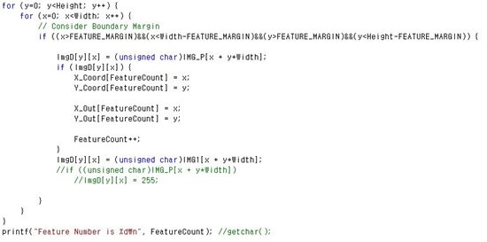

Currently, I develop a computer vision algorithm using VLIB of TI on visual studio 2010 on PC.
The problem is the bad result of optical flow function.
To perform optical flow, I input two successive image frames. and 1) Smooth filtering, 2) Find gradient, 3) Find Harris corner (VLIB_harrisScore_7x7, VLIB_nonMaxSuppress_7x7_S16).
And then, I check the output data of VLIB_nonMaxSuppress_7x7_S16. If this value is non-zero, it means it is the Harris corner, right ?
Below is the source of find feature point list for optical flow.
After find the feature point list, I call the optical flow function like as below.
