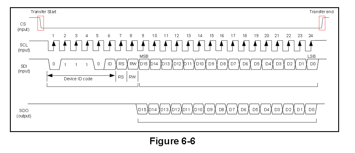

hi,
Is it possible to send a 24 bit data transfer by using TMS320C6745 SPI protocol................

Programmable character length for SPI on C6745 can only be between 2-16 bits but if you transmit 24 bit data as 8 bit characters without any wait delay between 8 bit data ..you can transmit 24 bits. Not sure if this helps as you haven`t mentioned any details on the use case.
Let us know if you have any follow up questions regarding this.
Rahul
Hi Rahul,
Here i attached my SPI Slave device timing diagram for your reference. if i transmit 24 bit data as a 3 8 bit data, then how the slave device will understand as which one is device id or data, ?. am using SPI TFT. i first plan to display an image in TFT. but its not working. if you well knowledge at SPI . please follow my post and reply.
