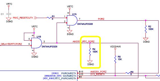

I have a simple question about am335x pin configuration.
If RTC is not used, how should we configure the RTC_PWRONRSTN pin?
I checked am335x datasheet, trm and schematic checklist (wiki). I coluldn't find it.

Hi Biser,
Thank you for your quick reply.
I understood that RTC_PWRONRSTn should be pulled up to VDDS_RTC when RTC is not used.
By the way, Where is that written?

Please hold for a final answer to your question.
I'm concerned the suggestion from Biser does not properly reset the RTC logic. The RTC may need to be reset even when it is not being used. I will try to provide an answer in the next couple of days.

Hi Biser,
AM335x Schematic Checklist on Wiki page was updated and I was confused again about RTC_PWRONRSTN.
http://processors.wiki.ti.com/index.php/AM335x_Schematic_Checklist#RTC
Wiki says RTC_PWRONRSTn connect to "Digital GND" if RTC is not used.
The last time I undersood RTC_PWRONRSTn should be connectted to "PORz" if RTC is not used.
Which is correct ?
-Takao

By the way, I'd liket to confirm this subject again. We will never use the RTC features.
If RTC is not used, RTC_PWRONRSTn should be connected to "PWRONRSTn ", or "Dgital GND"?

Thank you for the quick reply.
So Wiki is wrong?
