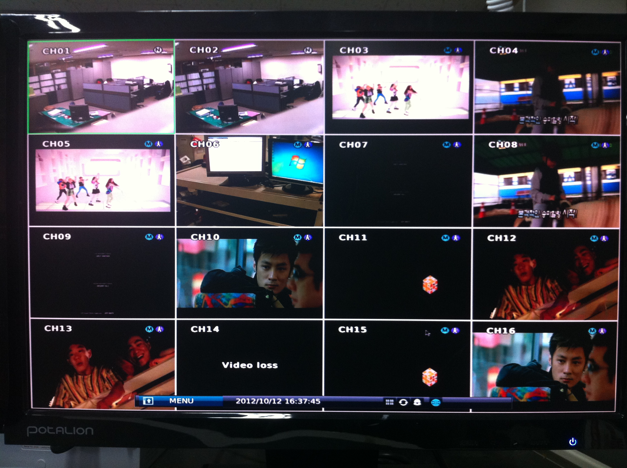

AVSYNC error . how can i reset m3vpss ?
6406.201210020942.pdfI'm using TI8167 , udworks DVRRDK03.00.00.00
I think this error  caused by  asynchronous CVBS input. How can I solve this problem?
can i detour this problem by m3vpss reset?
[m3vpss ] AVSYNC:WallTime IGNORE Unexpected Discontinuity.PrevTs[9391770]/CurTs[9394072]
[m3vpss ] AVSYNC:WallTime IGNORE Unexpected Discontinuity.PrevTs[9394322]/CurTs[9396658]
[m3vpss ] AVSYNC:WallTime IGNORE Unexpected Discontinuity.PrevTs[9397008]/CurTs[9399294]
[m3vpss ] AVSYNC:WallTime IGNORE Unexpected Discontinuity.PrevTs[9399511]/CurTs[9400352]
[m3vpss ] AVSYNC:WallTime IGNORE Unexpected Discontinuity.PrevTs[9400352]/CurTs[9402080]
[m3vpss ] AVSYNC:WallTime IGNORE Unexpected Discontinuity.PrevTs[9402131]/CurTs[9402281]
[m3vpss ] AVSYNC:WallTime IGNORE Unexpected Discontinuity.PrevTs[9402281]/CurTs[9403041]

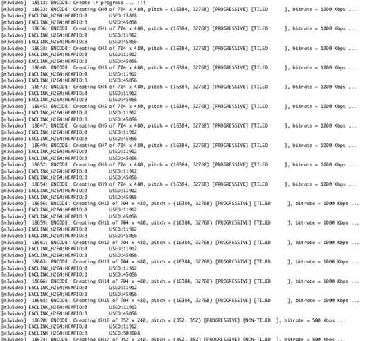

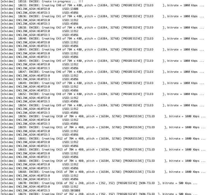

    and test it . The result is much better, live screen recovered. but sometimes it doesn't recovered within 3 minutes.
    and i can see the same avsync error. i attached full log and screenshot.
    can you advice me any tuning point in the source code and where modify and test?
    Best Regards. CHO8357.201210051031.pdf
  • i attached my issue video .
  • Hi Narayanan.
    when videoloss channel detected , i can indicate it.
    maybe if i indicate videoloss channel to the m3video or force reset m3video,
    is it possible make a detour this issue?

    [m3video] 18633: ENCODE: Creating CH0 of 704 x 480, pitch = (16384, 32768) [PROGRESSIVE] [TILED ], bitrate = 1000 Kbps ...
    i attached Vsys_printDetailedStatics result and test screen(DVD video and TV video).  this issue is occured in dark night( 0, 1, 2 hour).
    Do you think dark night noise and DVD video is an indirect cause of this issue?
