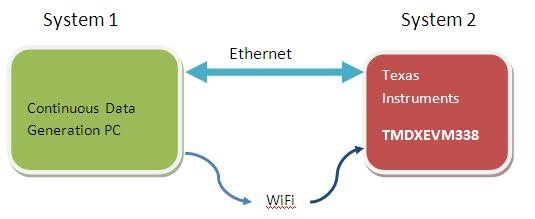

We have a host PC which is generating some continuous string data. This system is x86 based.
Whatever the continuous data is being generated on the system1, has to transfer to EVM board. Both the systems are connected either through Ethernet or Wi-Fi in peer-to-peer connection. To transfer the data from system1 to system2 (EVM), we are using simple Client-Server communication C code (socket programming).
Server code is already written at system1 side to send generated data. We have a simple Linux Client code which we want to put on EVM to establish the connection. Sample client code is written for x86 platform. We need to deploy the same on EVM board to establish the connection and exchanging of data.

  • HI Renjit,
    Thanks for providing me the information. I have already done with the steps you cited above.
    We are going to deploy Linux client Ccode on EVM. Server code is going to stay at system1 side(host PC).
    We are done with compiling, building the client code and at the point just want to make sure that the generated elf-arm executable is going to run on EVM without causing any error ?
