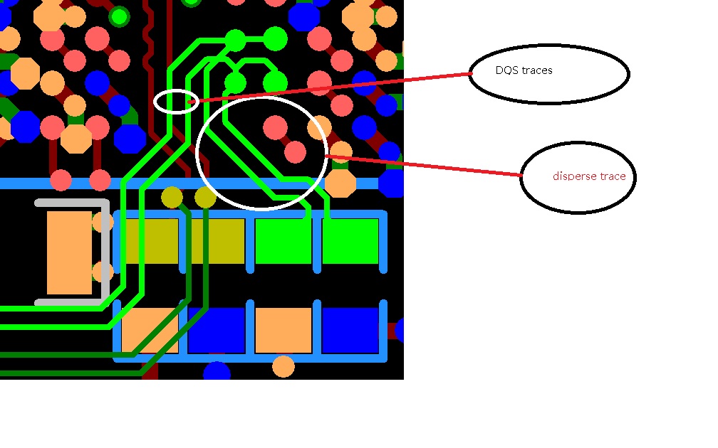

    In my design, we used one DDR3 controller as our costdown product,and two DDR3 controllers(include CDDR0 and CDDR1) as High perphermace product,
    So I have to draw DDR3 memory and pull-up/down resisters in same design, this will make routing traces disperse, please see the trace below photo.
    Because the DQS and DQSn signals are very sensitive,I'm not sure this trace disperse may affect on Signal Integrity?
  • Hi Iverson,
    This makes it a little bit complicated indeed. I would suggest something like this: route DQS/DQSn traces from processor pad through pullup/pulldown resistor pad and then on to the memory chip. You can place these pullup/pulldown resistors whereever it' most convenient, no need to bunch them next to the processor where space is really tight. I'm even thinking that it will be better if they are on the far end of the lines, so that DQS/DQSn traces will not act as antennas when there is no memory attached.
    Another idea may be to break the DQS/DQSn traces by inserting 0Ohm resistors.
