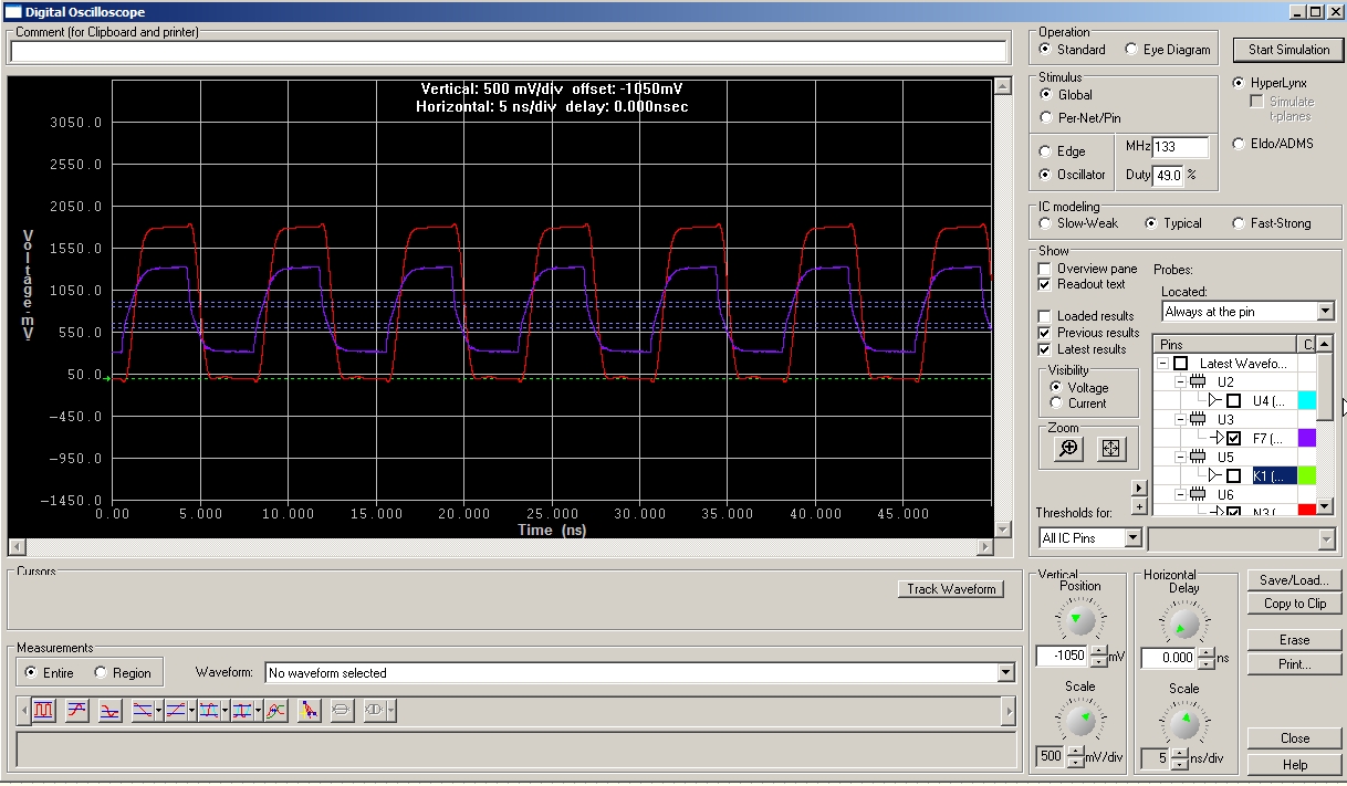

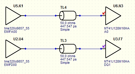

im attempting to use the 6657 ibis model but when i try to assign the model in hyperlynx the only option  i have is that the model is an input.  it  does not matter what siognal im looking at wheter is emif address or data.  The address should be an output and the data should have both input and output options avaialble to select.
