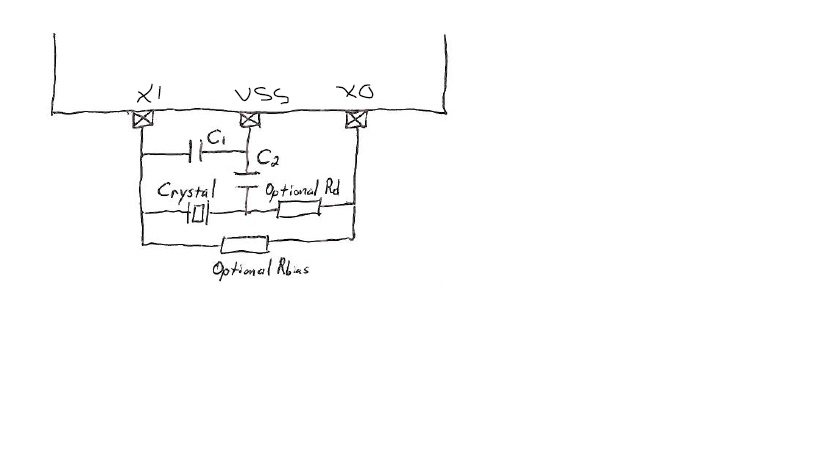

  3. Can the 24MHz oscillator be trimmed by using a small trim capacitor?

    3.Can the 24MHz oscillator be trimmed by using a small trim capacitor?
    [Lawrence]  In the AM18x Datasheet, see section “5.5 Crystal Oscillator or External Clock Input” for recommendations and requirements.  In general, C1 and C2 represent the total capacitance of the respective PCB trace, load capacitor, and other components (excluding the crystal) connected to each crystal terminal. The value of capacitors C1 and C2 should be selected to provide the total load capacitance, CL, specified by the crystal manufacturer.
    I’d also add that it’s a good practice that your pre-production printed circuit board designs include two optional resistors Rbias and Rd in case they are required for proper oscillator operation when combined with production crystal circuit components. In most cases, Rbias is not required and Rd is a 0-Ω resistor. These resistors may be removed from production PCB designs after evaluating oscillator performance with production crystal circuit components installed on pre-production PCBs.  I’ve attached a diagram showing Rbias and Rd, for reference.
