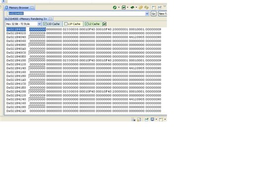

      I fed  RCLK, XCLK, RFS and XFS to the EVM 80-pin Connector from an external source. I defined the MCBSP driver
    /**< clock setup for the TX section */
    Mcbsp_ClkSetup mcbspClkConfigTx =
    Mcbsp_FsClkMode_INTERNAL, //Mcbsp_FsClkMode_EXTERNAL
    8000, /* 96KHz */
    Mcbsp_TxRxClkMode_INTERNAL, //Mcbsp_TxRxClkMode_EXTERNAL
    Mcbsp_FsPol_ACTIVE_HIGH,
    Mcbsp_ClkPol_RISING_EDGE
    /**< clock setup for the RX section */
    Mcbsp_ClkSetup mcbspClkConfigRx =
    8000, /* 96KHz */
    Mcbsp_ClkPol_FALLING_EDGE
    However I do not see MCBSP running. FPGA is written with decimal value 11 to disable FPGA to drive the MCBSP.
    Did anyone try the EVB with External clocks/Framesyncs? Should we feed SCLK too?
    It appears that Tx Does not begin.
    Hari

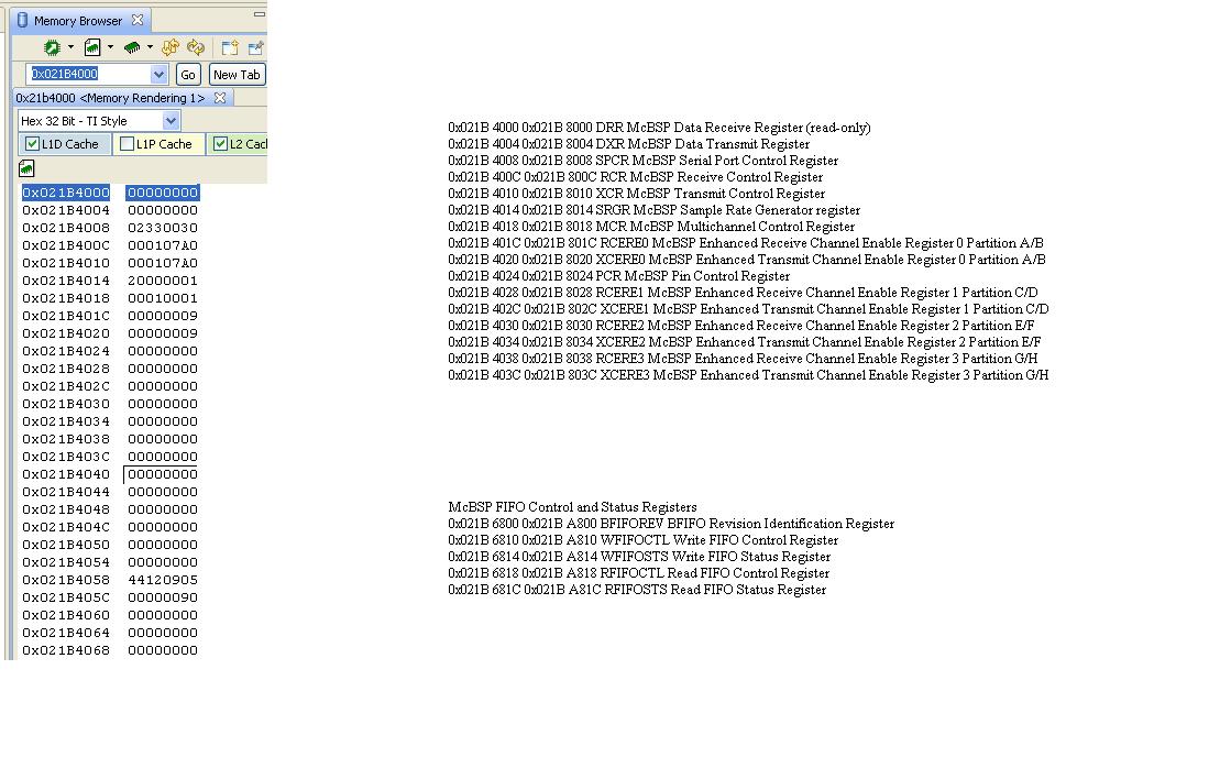

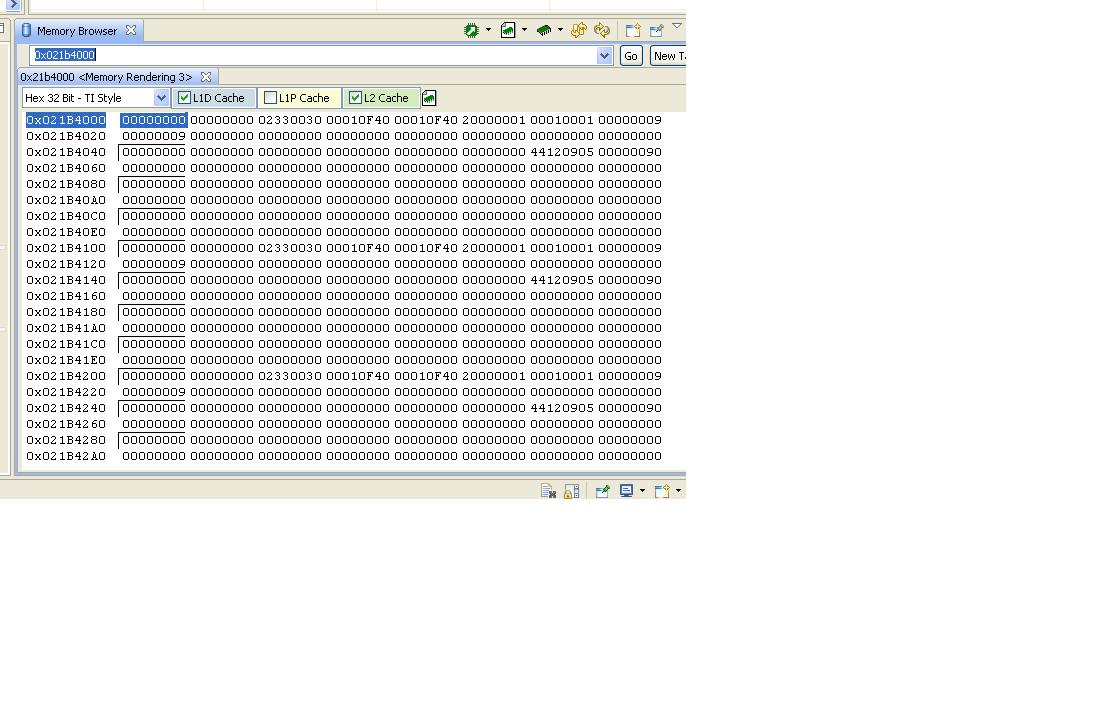

  • MCBSP on External Clocks/Frame Syncs
    Board: TMDSEVM6657
    Alpha version.
    We provided clocks on 80-pin connector:
       DSP_MCBSP0_RXCLK, TXCLK, FSR, FST from an external source of 2.048MHz Clock and 8.0 KHz frame Sync.
    Then I am running the board with the modifications at:
    Mcbsp_FsClkMode_EXTERNAL, //Mcbsp_FsClkMode_INTERNAL,
    8000, /* 96KHz */
    Mcbsp_TxRxClkMode_EXTERNAL, //Mcbsp_TxRxClkMode_INTERNAL,
    8000, /* 96KHz */
    MCBSP TX never Begins. I do not get edmaTxDone set.
    Disabled DLB mode too. - Does not kick in.
  • Can anyone help in getting the MCBSP to run with External Clocks/Frame Syncs source?
