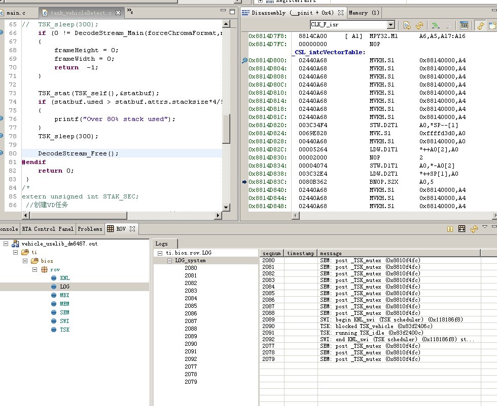

I create a simple project in ccs4.1with DSP/BIOS 5.41 for run the h264decode function use the HDVICP of DM6467T.
But when i decode one frame i found that the CLK_F_isr() function cannot be called (when i don't call the decode function the CLK_F_isr() can be called). So all the timeout function of DSP/BIOS API don't have effect, such as TSK_sleep(10) and so on. In the ROV of DSP/BIOS 5.41, I found the message "SEM: post _TSK_mutex"  in LOG_system modules. So my question is what's the meaning of SEM: post _TSK_mutex, and why the CLK_F_isr() can not be called(that means  system clock cannot drived by the Timer0 or Timer1 in DM6467T)?

  • Thanks for your replay.
    I don't use the SEM_post(_TSK_mutex) in my program, so i guess the SEM_post(_tsk_mutex) called by the lib in my program. I use the HDVICP lib to decode H264 stream in dm6467t. I want to know how to stop the SEM_post(_TSK_mutex), because i don't know which function run SEM_post(_TSK_mutex). You can found in the last post pic that there is not CLK info in my task, that means the TIMER0 of system lost effect, and the timeout of DSP/BIOS API lost effect.
    Thanks.
  • I believe that the calls to SEM_post() in your application are coming from an IDL function that periodically invokes C library functions for performing HOST I/O to exchange RTA data between CCS and the target processor.
    This IDL function is part of the target/host logging mechanism which drives the LOG module ROV view you show in your post.
    The C library function calls the lock() and unlock() APIs I described above.
    Apparently only the SEM_post() call is being logged.
    Alan
  • Thank you for your replays.
    You are correct, I found the SEM_post send by the RTA module.
    Thanks a lot.
